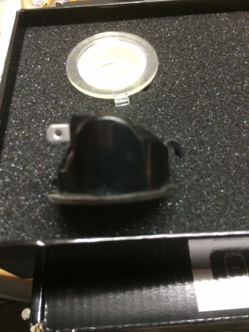

I need some help guys. The Drive Bright puddle lights and DRL’s that I ordered for my 2014 Edge just arrived. I started on the easiest install first, the puddle lights. I watched Drive Bright's installation video and it looked like a piece of cake. Unfortunately, it wasn’t.
The puddle lights that I received look very different from the puddle lights shown in the installation video. The wiring pins of the OE fixtures are on the sides of the fixture, but the Drive Bright pins are on the top. This seems to prevent them from going up into the mirror correctly. The locking tabs are also different. The OE locking tabs are higher up on the fixture than the one’s from Drive Bright. The Drive Bright lights will not snap into place. They fall out as soon as the door is closed.
I looked at the box the lights came in and it does indeed show that it fits my Edge, but something is very wrong. I sent an email to Dan the owner, so I will wait and see what he says. In the meantime, has anybody else had this issue with Drive Bright puddle lights? Am I doing something wrong? :headscratch:

DRIVE BRIGHT PUDDLE LIGHTS
I really don't know what the problem (if there is one) might be. You'll just have to wait and hear from Dan. In the past his customer service was always excellent, and hopefully that hasn't changed.
What I do want to comment on is the amateurish appearance the modified light base appears to have. Looks like a terrible job of sealing the base, and it even looks like there is contact cement or whatever sealant was used is even on the one terminal where the electrical connector goes. The appearance really doesn't have anything to do with the function, unless it is poorly done and moisture can get in there. If the terminal does have sealant on the one lug, that is not a good sign of quality control in my opinion.
Hopefully I am wrong and that is perhaps something on there from your attempt to install it. If not, then I would not be too motivated to purchase from the company again. I did get his DRL's for my Edge and they were first rate! That light you took a picture of looks like Made In China 100%!
I attempted to install the lights as per the instructions....no more, no less. The messy white stuff you see is silicone. There was a lot of it on the electrical contacts as well. So much so, that I was afraid it would prohibit a solid connection, so I had to scrape it off of the contacts.
Although I was disappointed in the quality appearance of the fixture, my main concern is the locking tabs and the position of the electrical contacts. They are not the same as the OE light fixture, which I assume is the reason it won't snap/lock into place.

I received an email reply from Dan of Drive Bright. He said this is a new puddle light for him and he admits there have been some fitment issues. He is currently changing the design to move the electrical contacts to the side and is improving the locking tab, both of which I had problems with. He said the new light will be ready in about 10 days. He was very apologetic and asked if I would mind waiting for the new light. He seems to be a stand up guy, so I don’t mind the wait.

Yeah, the lights he sent me are totally different, as you can see. I'm sure the revised lights he sends me will work better.

I had the same type of fitment issues with the new design puddle lights. It took a lot of odd bending of the connectors to get it to fit back into the base. The connectors are so close together I fear they may contact under any pressure, so I had to wrap one lead in electrical tape just to be sure. My question is since the leads point up, is there any chance that the wires will get caught up in the gears for the power mirrors?
These puddle lamps replaced the older version of the puddles I got from Dan, which eventually failed (little to no light when opened) I think something came loose inside since when I put these new versions on it was nearly blinding. Hope these last longer!
