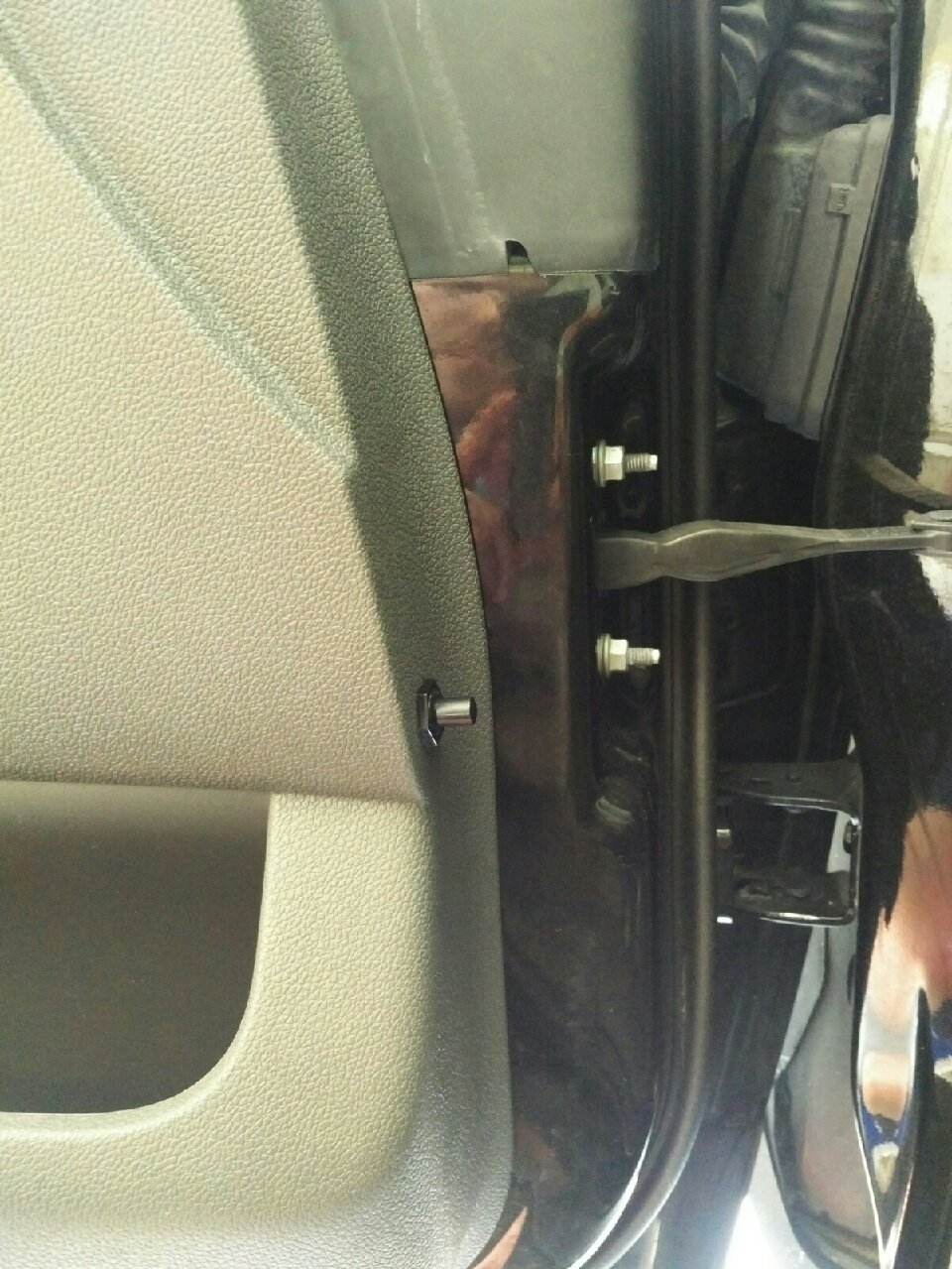

pilotdog68 Posted March 30, 2017 Report Share Posted March 30, 2017 (edited) I gather from your response to him that you used the fix I described, but that it works consistently for you? If so, could you tell me what reed switch you used? My installation is illustrated in post #11 if you wanted to compare, though it sounds like your reed switch is just sticky (or maybe you have some stray magnetism around it?). I harvested my switch from this model security alarm, which I just had sitting around. As I said, I haven't been having any issues with it. Although I'm annoyed my Edge had this problem in the first place, I'm quite happy with the fix. Edit: Looking back at your pictures, I think the magnet in the door speaker may be close enough to your reed switch to cause some issues. Edited March 30, 2017 by pilotdog68 1 Quote Link to comment Share on other sites More sharing options...
dbender Posted April 4, 2017 Report Share Posted April 4, 2017 I'll bet you're right about the speaker magnet. One of these days I'll take the door liner off and move the switch. Thanks for the idea. Quote Link to comment Share on other sites More sharing options...

SpanielChung Posted July 3, 2017 Report Share Posted July 3, 2017 After years of using forums like this to help fix my BWM, decided to go and get "something more reliable". Bought an edge with 60k on the clock and after 2 months the door ajar problem came and stayed. I still can't believe Ford are not recalling their cars for this problem, it's criminal because it is not something that can just be ignored. After some trial and error I ended up with a variation on the reed switch solution and thought I'd share it for all the other Edge owners that will inevitably end up with the problem. It's basically the same, but with a normally open push to make switch mounted just inside the door. You can't see it unless you look for it, and if it fails in the future it should be easy to replace. If I did this again, I would probably use a wire harness to connect the new switch. For this project I just soldered the wires and wrapped with electrical tape. http://www.frys.com/product/2874724?site=sr:SEARCH:MAIN_RSLT_PG Massive thanks to all who shared their solutions and info about which wires to chop! 3 Quote Link to comment Share on other sites More sharing options...
