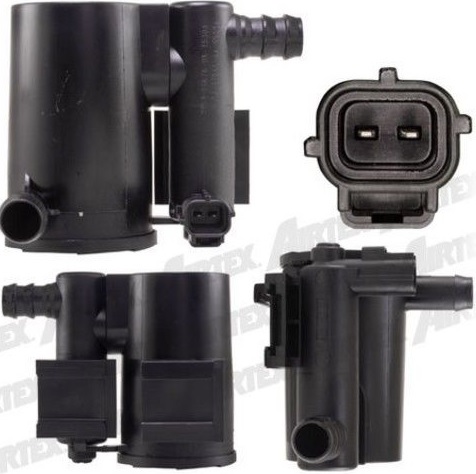

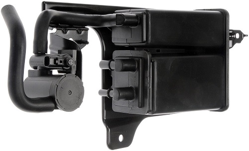

WWWPerfA_ZN0W Posted April 5, 2015 Report Share Posted April 5, 2015 (edited) Okay, so that's the Vapor Canister Purge Solenoid and Vapor Canister (CX-2106), respectively, collectively not more than $450 if you pick the parts up at the counter, or $250 off of EBay. CANISTER SOLENOID DIAGRAM 1 DIAGRAM 2 Edited April 5, 2015 by WWWPerfA_ZN0W 1 Quote Link to comment Share on other sites More sharing options...
macbwt Posted April 5, 2015 Report Share Posted April 5, 2015 Overall looks very doable as far as replacement. Definitely a job to plan ahead for, but ordering the parts would be far less costly. After looking at the diagram.....I would do it. After all how hard can it be....? Forgive me for laughing at myself. I support you to perform the work yourself you have everything to gain and lots of money to lose. Go for it!!! 1 Quote Link to comment Share on other sites More sharing options...
