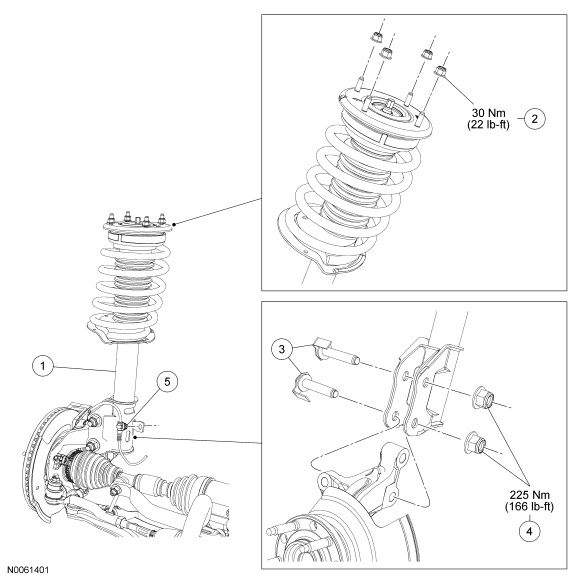

WWWPerfA_ZN0W Posted March 18, 2015 Report Share Posted March 18, 2015 (edited) Well, they make it sound simple: Item Part Number Description 1 — Shock absorber and spring assembly 2 W520212 Shock absorber upper mount nuts (4 required) 3 W712555 Shock absorber lower flag bolts (2 required) 4 W520216 Shock absorber lower nuts (2 required) 5 — Wheel speed sensor harness clip Removal and Installation Remove and discard the 4 shock absorber upper mount nuts. To install, tighten to 30 Nm (22 lb-ft). Remove the wheel and tire assembly.Remove the shock absorber lower nuts, flag bolts and the shock absorber and spring assembly. Discard the nuts and flag bolts. To install, tighten to 225 Nm (166 lb-ft). To install, reverse the removal procedure.Check and if necessary, adjust the alignment. Edited March 18, 2015 by WWWPerfA_ZN0W 1 Quote Link to comment Share on other sites More sharing options...
macbwt Posted March 18, 2015 Report Share Posted March 18, 2015 The hard part is getting to the top nuts of the strut. Imagine doing this and replacing the LCA at the same time. On 3/18/2015 at 7:32 PM, WWWPerfA_ZN0W said: Well, they make it sound simple: 2007 Edge_Front Shock & Spring Assembly.gif Item Part Number Description 1 — Shock absorber and spring assembly 2 W520212 Shock absorber upper mount nuts (4 required) 3 W712555 Shock absorber lower flag bolts (2 required) 4 W520216 Shock absorber lower nuts (2 required) 5 — Wheel speed sensor harness clip Removal and Installation Remove and discard the 4 shock absorber upper mount nuts. To install, tighten to 30 Nm (22 lb-ft). Remove the wheel and tire assembly.Remove the shock absorber lower nuts, flag bolts and the shock absorber and spring assembly. Discard the nuts and flag bolts. To install, tighten to 225 Nm (166 lb-ft). To install, reverse the removal procedure.Check and if necessary, adjust the alignment. Quote Link to comment Share on other sites More sharing options...
