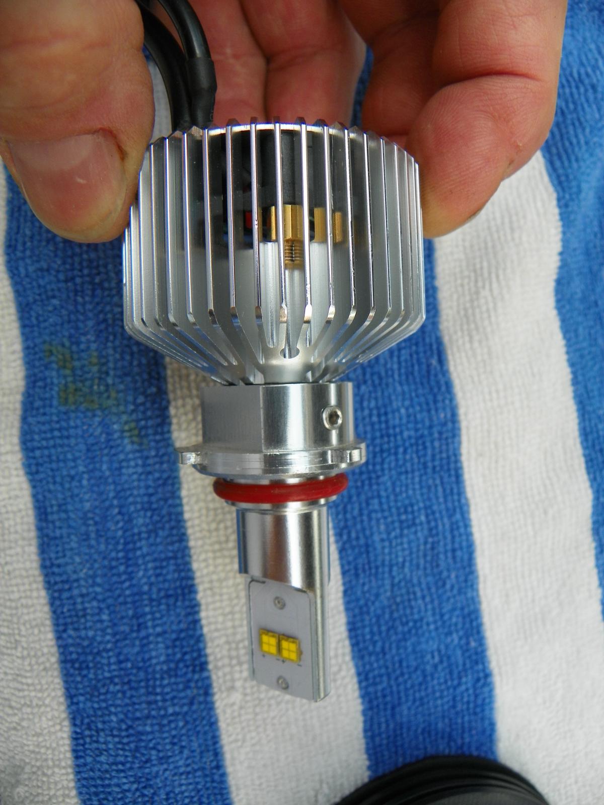

I had to do some more adjusting with the way the bulb was oriented in the housing. I was reading where some other people that had purchased them were doing some testing for better beam patterns. The LEDS had to be pointing top and bottom in my housing for best results. With the way the grooves were in the bulbs and the set screws in the collars, no matter how I set them the LEDS ended up not pointing top and bottom. So I drilled out the set screws from 6-32 to 10-32 and used 2 screws in each collar, seeing how the screws weren't going to seat in the grooves, this way I would have enough holding power to be able to lock the bulbs in the collars to keep them from turning when I twisted them in the housing.

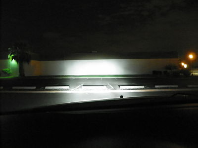

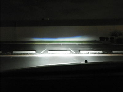

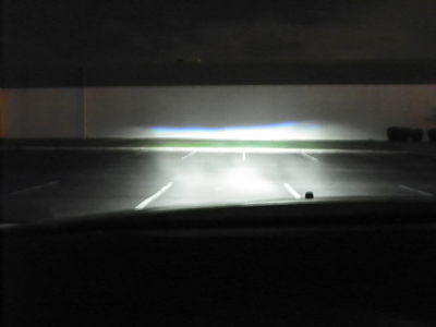

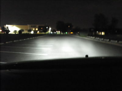

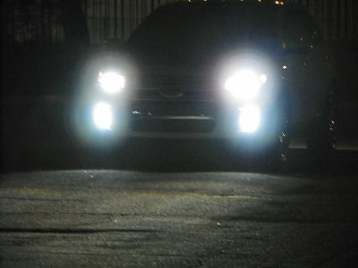

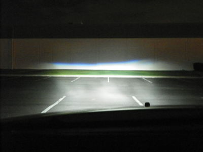

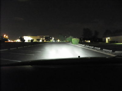

Sorry for not getting back here for a while but I finally had a chance to get them adjusted and take some pics. I got the cutoff line good so that I don't shine in the oncoming drivers eyes. The light pattern is bright and pretty full. I really like the results, way better than the halogen bulbs that were in there. I was talking with a gentleman at V Leds and he was saying that the halogen lens isn't that clear and has those little bumps on it, that some people change out the lens to a clear lens like the better HID lights have. So that got me thinking and reading a lot on HIDplanet. There is a better direct replacement projector by the retrofit source called the EVOX-R. It is even better than the Hella55 that come stock on Ford HIDs. So I am going to order a set and give those a try. I will have to bake the light housing to soften the sealer and take them apart but for what I have been reading the benifits are well worth it. I found an article where a guy compared the V-LEDS led in a good projector to be as good as the HID bulbs.
The first pic is the V-LED housing where I put 2 larger set screws to secure the collar to the bulb.
The last 3 pics are with the high beans on.
