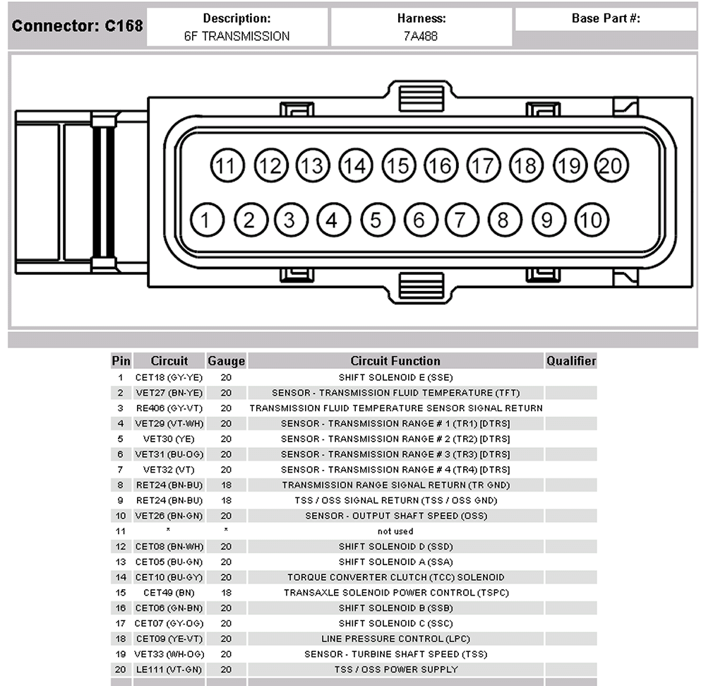

andi74 Posted March 11, 2015 Report Share Posted March 11, 2015 I need help Edge 2013 FWD 2.0 Ecoboost sorry for my bad english ( i am from Europa) i have problem with Transsmion Connector i was litle crash with wild fox i need wiring diagram for Transsmion Connector with Color of wiring and lockate the pins ( 14 pin) i have Edge FWD 2013 2.0 Ecoboost with 6F Mid gear transsmision (not the 6F55) i have new conector from ebay i need this now change but the old is damaged in europa ford had not suport for ford edge us model Quote Link to comment Share on other sites More sharing options...

andi74 Posted March 12, 2015 Author Report Share Posted March 12, 2015 from internet for 6F55 on the net this is Connector Transsmision C168 for 6F55 http://repairguide.autozone.com/znetrgs/repair_guide_content/en_us/images/0996b43f/80/7d/2e/b3/small/0996b43f807d2eb3.jpg i need this same but for 6F 2013 Mid Range with only 14 Pin Wiring Quote Link to comment Share on other sites More sharing options...

andi74 Posted March 12, 2015 Author Report Share Posted March 12, 2015 i need for this connector 6F35 TRANSMISSIONC1520B 6F35 TRANSMISSIONC1520A this is the same ???? als C168 ?? Quote Link to comment Share on other sites More sharing options...
