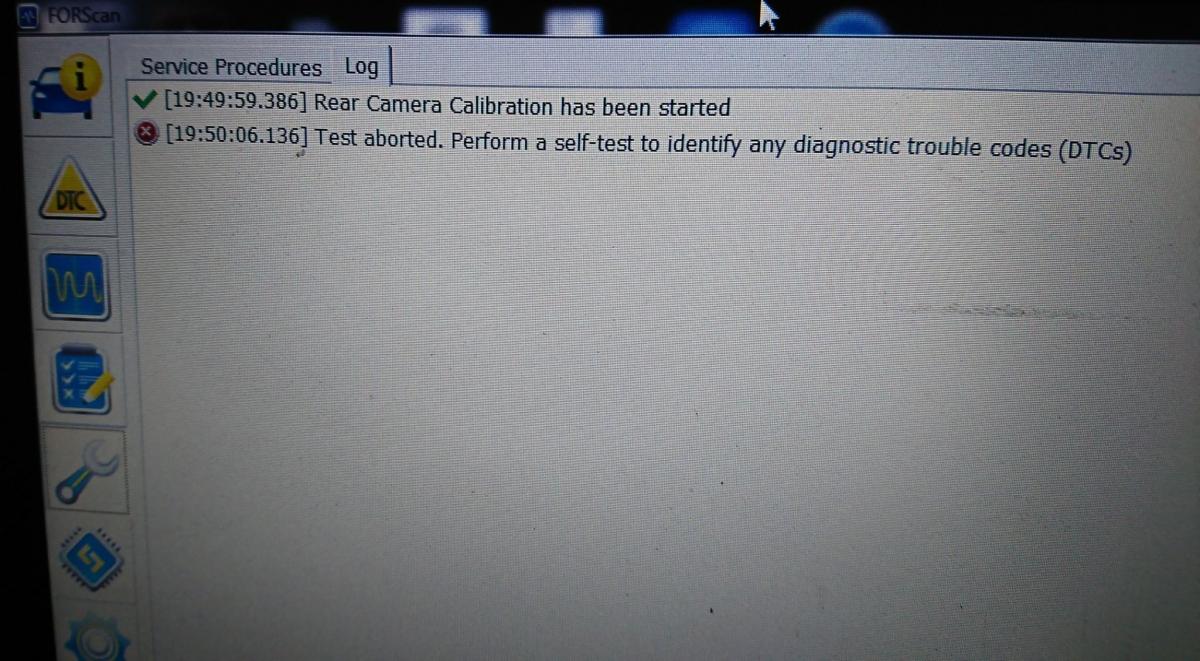

WWWPerfA_ZN0W Posted November 27, 2017 Report Share Posted November 27, 2017 Anyone run into this error using Forscan for Windows EL? Trying to recalibrate a new Ford camera Quote Link to comment Share on other sites More sharing options...
candurin Posted November 27, 2017 Report Share Posted November 27, 2017 Did you get the camera from ford or was it a 3rd party (e.g. eBay) camera? I ask because ForScan has notoriously had issues with completing the calibration routine with non-OEM replacement cameras. If you look at the DTCs, so you have a B115E:08-48 error? Quote Link to comment Share on other sites More sharing options...
WWWPerfA_ZN0W Posted November 27, 2017 Report Share Posted November 27, 2017 From an eBay seller selling Ford parts. No DTCs to report Quote Link to comment Share on other sites More sharing options...
candurin Posted November 27, 2017 Report Share Posted November 27, 2017 (edited) Hmm... If it's a knockoff, then perhaps that can be the issue. From what I read on the FORScan forum, it's not a FORScan issue (at least they are not willing to take any blame). http://www.forscan.org/forum/viewtopic.php?f=6&t=4408 Edited November 27, 2017 by candurin 1 Quote Link to comment Share on other sites More sharing options...
WWWPerfA_ZN0W Posted November 28, 2017 Report Share Posted November 28, 2017 Good info! I will dig into the hardware end, see if I can verify the camera manufacturer. Quote Link to comment Share on other sites More sharing options...
