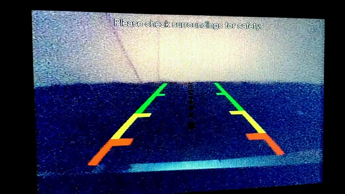

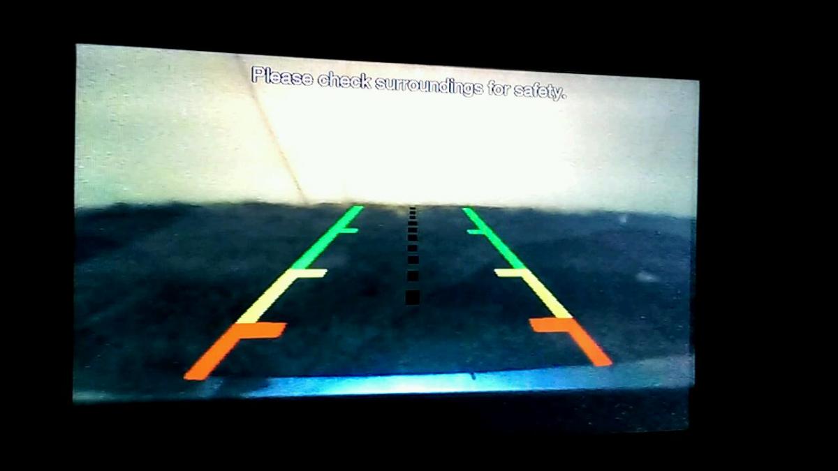

omar302 Posted May 31, 2015 Report Share Posted May 31, 2015 I have a different Camera issue, dealer said they will replace the camera to resolve it. Basically, my problem is that the camera would become very noisy (grainy) at night if I had been driving for a while and the weather was hot. Shutting off the car for ~2 minutes & restarting, the Camera would become clear. Same place, same time, same lighting. Before shutting off the engine: After shutting off, ~2 minutes & restart: Video I made, non stop shooting: https://youtu.be/547oSfgPJZs Quote Link to comment Share on other sites More sharing options...

Tacyon Posted June 29, 2015 Report Share Posted June 29, 2015 I've done a LOT of work with video over several careers. Based on the pictures you just posted and the one on page 1, it appears to be a grounding problem. WHICH would explain why the dealer ship won't touch it until you pay $$. Often grounding issues are a PIA to locate and once you "touch" the cause you could fix it with no needed parts. (real fix or temp, hard to judge) Or you may spend (as the tech) X hours and never find it. At which point they'd ask you, the customer, what cap do you want on time spent (labor) to search. maybe ... just a guess based on pictures and nothing else. Quote Link to comment Share on other sites More sharing options...

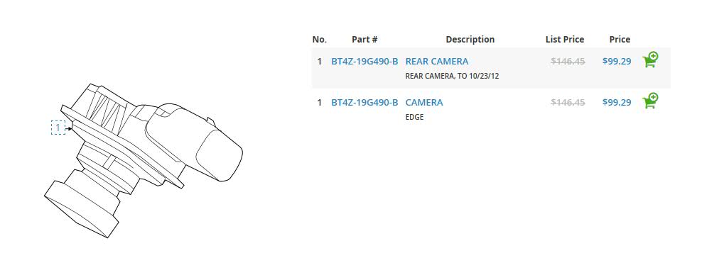

wlepse Posted July 30, 2015 Author Report Share Posted July 30, 2015 Wow...thanks to xK317Hx's method this was pretty painless. Took about 30 minutes. Hardest part was dremeling the screw. My initial mistake was not committing and the groove was too big initially. Once I manned up it was all good. The only change I made was a suggestion my wife made. I was struggling with my sausage fingers to get the screw back in...knowing some expletives were about to be used she suggested a zip tie. Worked perfect and next time it will be super easy to get out. Results were good, we now have a reverse cam again! As expected the colored lines and blocks are no longer present. Was going to try a master reset but from what I have read it needs to be reprogrammed by Ford. Really wish there was a diy programmer I could buy at a reasonable price. Anyway the good news is the beeps are still present, so between being able to see what is behind us and beeps we are good. 3 Quote Link to comment Share on other sites More sharing options...

wlepse Posted July 31, 2015 Author Report Share Posted July 31, 2015 I hear you on money being tight...seems you never have enough especially when you have kids. I will double check the box but I am almost 100% positive it matched the P/N shown in the pic. There really aren't two part numbers, I think initially there was a version of this camera that was used up to a build date in 2012, then they revised it. So many of the sites have two listings but if you look at the Ford P/N they are the same. The camera I got had a mfg date of like 2 months ago, the original said it was S/N 0011. So I think I had a really early revision. 1 Quote Link to comment Share on other sites More sharing options...
wlepse Posted August 1, 2015 Author Report Share Posted August 1, 2015 Ok...another update. Camera still provides an image but I am coming to the conclusion it is close to useless without the lines. It is very hard to tell how you are lined up due to the perspective it gives you...I still find myself turning around to line up with a space then when lined up I use the cam to tell when I am all the way in. I will give it some more time but I think I will be breaking down to get this programmed. So keep that in mind so you know the true cost to fix. For those that aren't handy you are probably better off letting the dealer do this. I was quoted $400 for the whole thing, right now I am in $100+ probably $150 to program so I will still save $150, but for some this might not be worth it. Quote Link to comment Share on other sites More sharing options...
