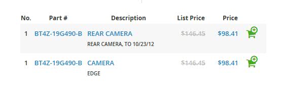

So one thing I noticed when ordering a new camera is that there is 2 listed a older dated one and and a newer one. Im going to try the newer one and see what happens. I base this fix souly on reading other forums and people having this issue fixed at the dealer, stating that the fix was replacing the camera and reprograming it to get the guide lines working.
