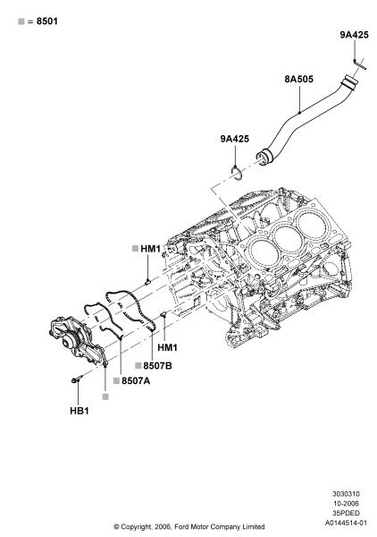

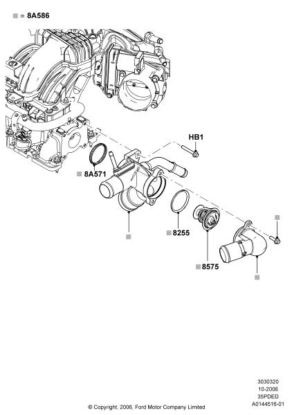

ls973800 Posted March 7, 2015 Report Share Posted March 7, 2015 (edited) Perhaps you can tell by these blow-ups? The first picture is for the water inlet hose. The second is the thermostat housing. It appears the piece you are asking about may be a part of the thermostat housing itself and not a separate part. You may have to stop at a Ford parts dealer and look at the housing. Edited March 7, 2015 by ls973800 2 Quote Link to comment Share on other sites More sharing options...
