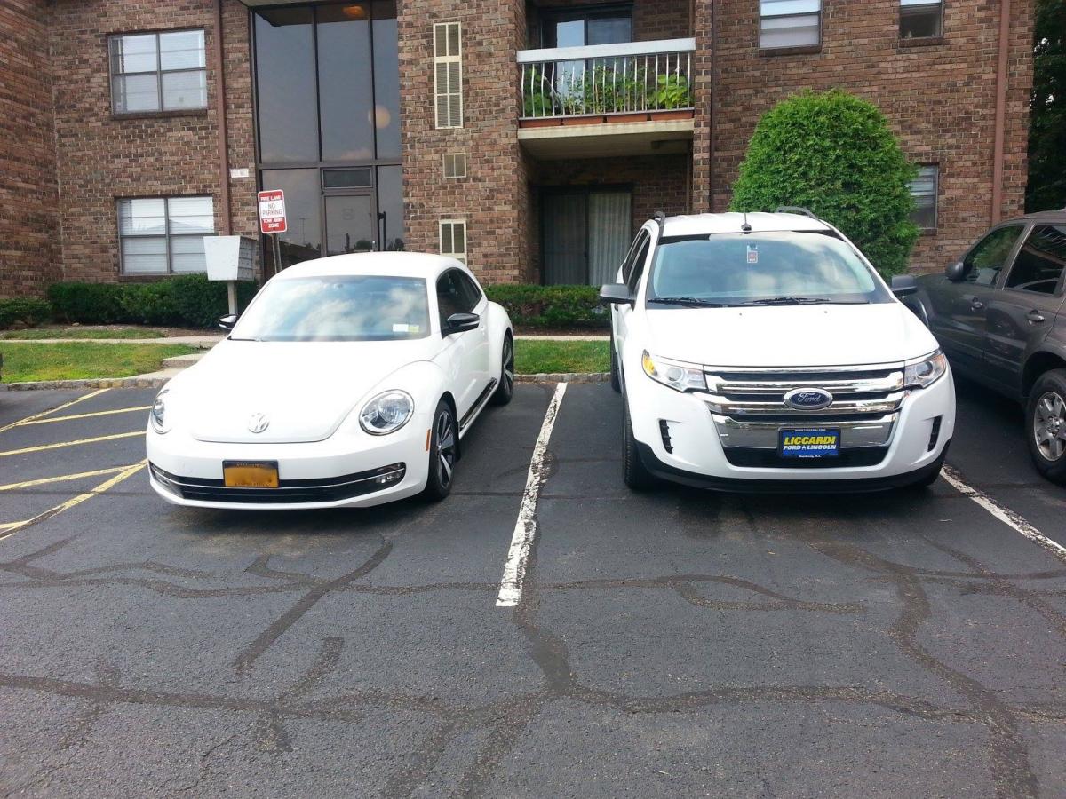

J0J0 Posted February 19, 2015 Report Share Posted February 19, 2015 (edited) I have a 3.5 AWD without the towing package. IF a job venture pans out for me in Florida, I will have to tow my wife's 2012 VW Turbo Bug from Rockland County, NY to Ft. Meyers florida. I know I have to put on the tow hitch and 4 pin wiring. I was looking on line for tranny and oil cooler to address the added heat/strain while towing. My wife's beetle's curb weight is about 2995 ibs. With that being said, have I covered all the bases for this potential tow of over 1200 miles? I know there is a setting to adjust for towing on the edge but I just want to make sure I covered all the bases for towing and not placing my Edge in a "bad place." The only alternative is having my wife follow me in her beatle but I don't think she's looking forward to driving 20+ hrs, following me in her beetle. She's not really a highway driver. She will only do it if absolutely necessary. BTW, her bug is a 6 speed manual, fwd. I was thinking of putting it up on a dolly and pulling it behind my AWD Edge. Edited February 19, 2015 by J0J0 Quote Link to comment Share on other sites More sharing options...
rtball Posted February 21, 2015 Report Share Posted February 21, 2015 If you MUST tow, a dolly is better than a full trailer due to the dead weight of the tow device. That will be a lot of weight to have behind you while traveling. Braking will be 'interesting' and scary if you aren't super careful. Highway posted speeds will not be your speed. The only hitch I would want, due to design, would be the Ford OEM hitch. I don't believe the other after market hitches have the capacity for your tow. I installed one of the Ford units on my '12 Edge w/Eco, since it wasn't available from the factory. My tows are light. An oil cooler might not be required, but would be added insurance. If you figure all of the expense you will incur, you might want to take an extra day and drive both vehicles. You will have vastly reduced gas mileage also. Part of the extra expense. Just my thoughts! Good luck. Quote Link to comment Share on other sites More sharing options...
J0J0 Posted February 22, 2015 Author Report Share Posted February 22, 2015 Since the OEM hitch is only a class 2, a class 3 would probably give me more peace of mind. I have been towing a 21' boat weighing 3700lbs (dry) for years with my Tahoe so yes, I understand the dynamics of towing. Overall, the expense of making my Edge more tow worthy won't be too much. I'd rather tow it than deal with the stress of having my wife follow me in her car. The hours of hearing the radio crackle with "slow down, I'm tired, I'm getting sleepy ... etc" would be worth avoiding Adding the towing upgrades would also allow me to tow some "toys" with the edge. I'm looking for more than just a single reason to add to the Edge. Thanks for your input! Quote Link to comment Share on other sites More sharing options...
