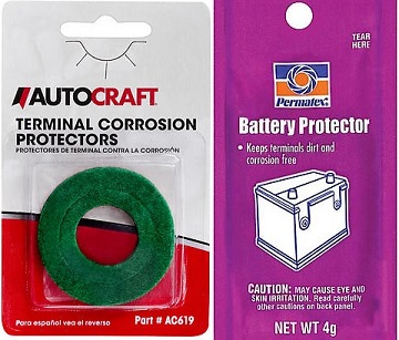

WWWPerfA_ZN0W Posted January 10, 2015 Report Share Posted January 10, 2015 (edited) Probably more important to check cabling for wear/breaks/corrosion. Clean any corrosion off. Apply felt washers to the terminals or an anti-corrosion compound/"battery protector" similar to this: http://shop.advanceautoparts.com/p/permatex-counterman-s-choice-battery-protector-09976/7730003-P http://shop.advanceautoparts.com/p/autocraft-anti-corrosive-battery-washers-2-piece-ac619/10200599-P Edited January 10, 2015 by WWWPerfA_ZN0W Quote Link to comment Share on other sites More sharing options...
