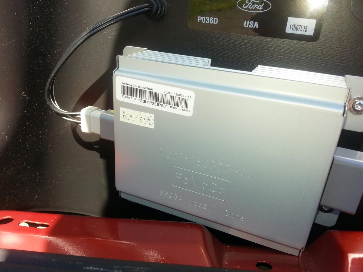

Tribby2001 Posted December 1, 2015 Report Share Posted December 1, 2015 (edited) I did a search for my 2010 Edge Limited AWD (6CD, No NAV, w/Sync) sub amp's part num. (8A5T-18C808-AB) and found a post in another forum that stated:Subwoofer Amp "10-11 amps X ~12 volts = 120-150 watts" - Don't know how accurate it is but seems feasible.I just opened up my OEM subwoofer to find an appropriate driver replacement. For the benefit of future passersbys, I measured the sub box (9T4T-18C804-AA) volume to be 13.7 liters or 0.48 cubic foot in volume. The box's subwoofer cut-out diameter is 7¼" and the max. sub depth is 5" in my sub box (there may be other sub box versions that are shallower). The subwoofer (6U5T-18808-UA) itself has dual 1.3Ω impedence voice coils. It's overall diameter is 8⅜" and is 3½" deep.I'm going to try to fit a 8" Kicker 40CWRT81 (fits) or 10" Kicker 40CWRT101 (box needs to be modified) which are the only subs I could find with dual 1Ω impedance voice coils to match with the OEM sub amp.I know this is not the ideal but it's cheap! Edited December 17, 2015 by Tribby2001 1 Quote Link to comment Share on other sites More sharing options...
