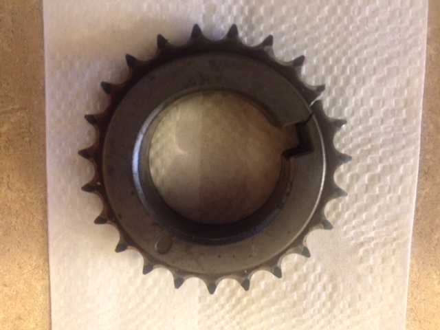

bapierce Posted December 23, 2014 Author Report Share Posted December 23, 2014 Oh it's np. Any idea what could cause the timing gear sprocket to crack and the key that holds it onto the crankshaft to shear? Was running fine, and when I was pulling it into the garage it just shut down. Quote Link to comment Share on other sites More sharing options...
WWWPerfA_ZN0W Posted December 23, 2014 Report Share Posted December 23, 2014 Is the sprocket plastic? Could be simple fatigue, or incorrect motor oil, or ... Here is a look into the problems with the older Ford modular engines, may shed some light: http://www.agcoauto.com/content/news/p2_articleid/115 Quote Link to comment Share on other sites More sharing options...
bapierce Posted December 23, 2014 Author Report Share Posted December 23, 2014 No the sprocket is metal. Was using full sythentic 5w-20. I think I figured it out though. I think my tensioner is bad. I'm able to push it in with my hand which I don't think I should be able to. So I ordered a new timing chain and tensioner, see what that that does if the valves aren't ruined. Quote Link to comment Share on other sites More sharing options...

bapierce Posted December 29, 2014 Author Report Share Posted December 29, 2014 (edited) heres a pic of the sprocket, still waiting on parts. Half of the key for holding the gear in place on the cranshaft is still stuck in the crankshaft so I gotta try to drill that out. Hopefully I don't damage the crank Edited December 29, 2014 by bapierce Quote Link to comment Share on other sites More sharing options...

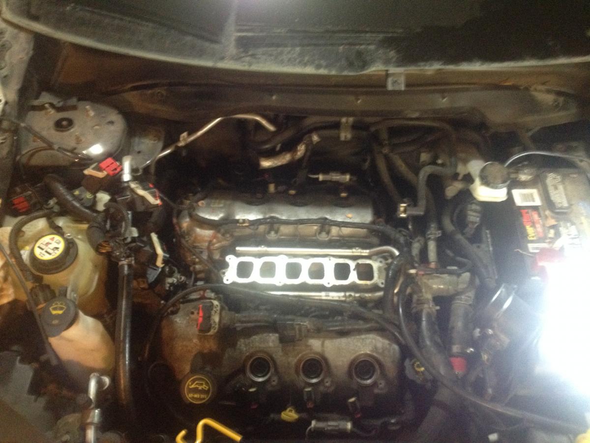

bapierce Posted January 12, 2015 Author Report Share Posted January 12, 2015 Got the engine back togather. Started it, and it wasn't running well. Did a compression test and number 6 is a dead cylinder. So going to just pull the engine and put a newer one in. We'll see how pulling the engine goes Quote Link to comment Share on other sites More sharing options...

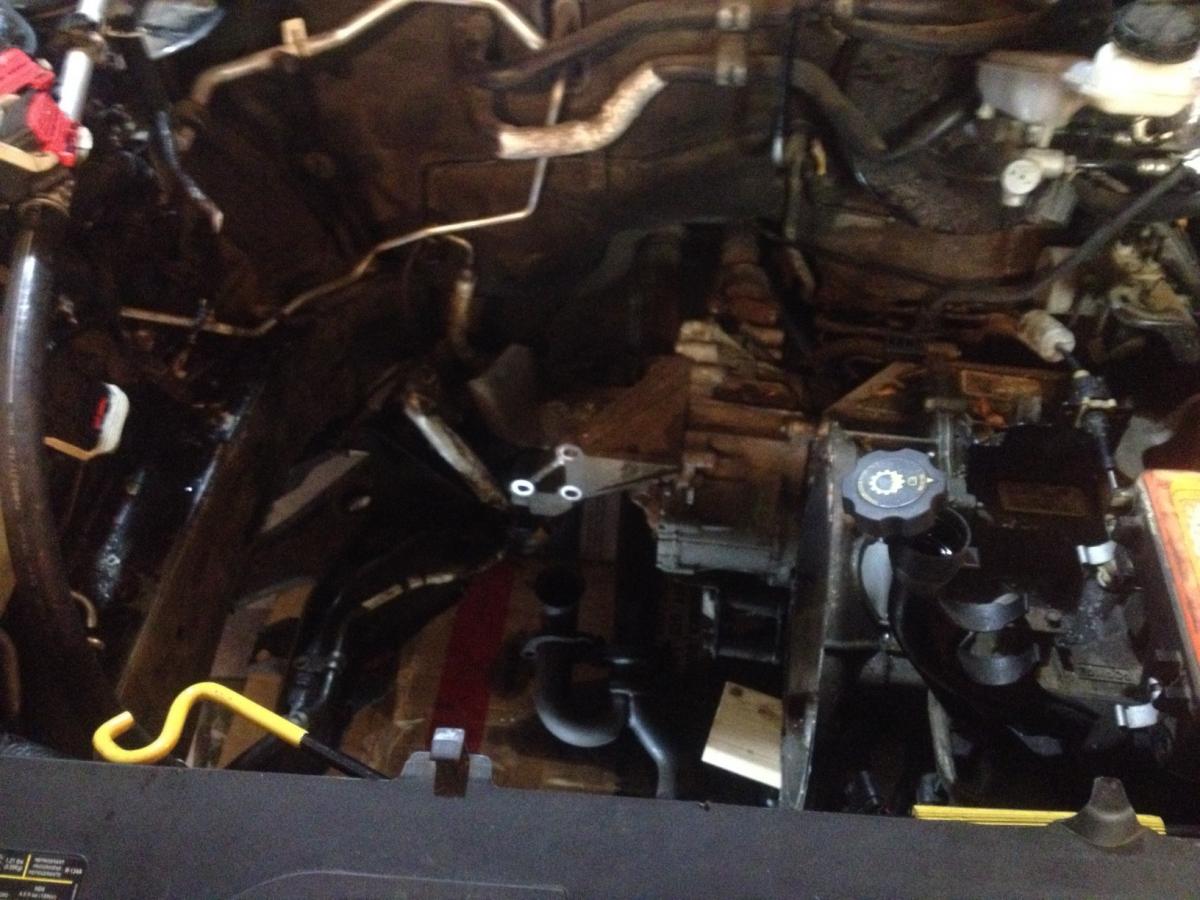

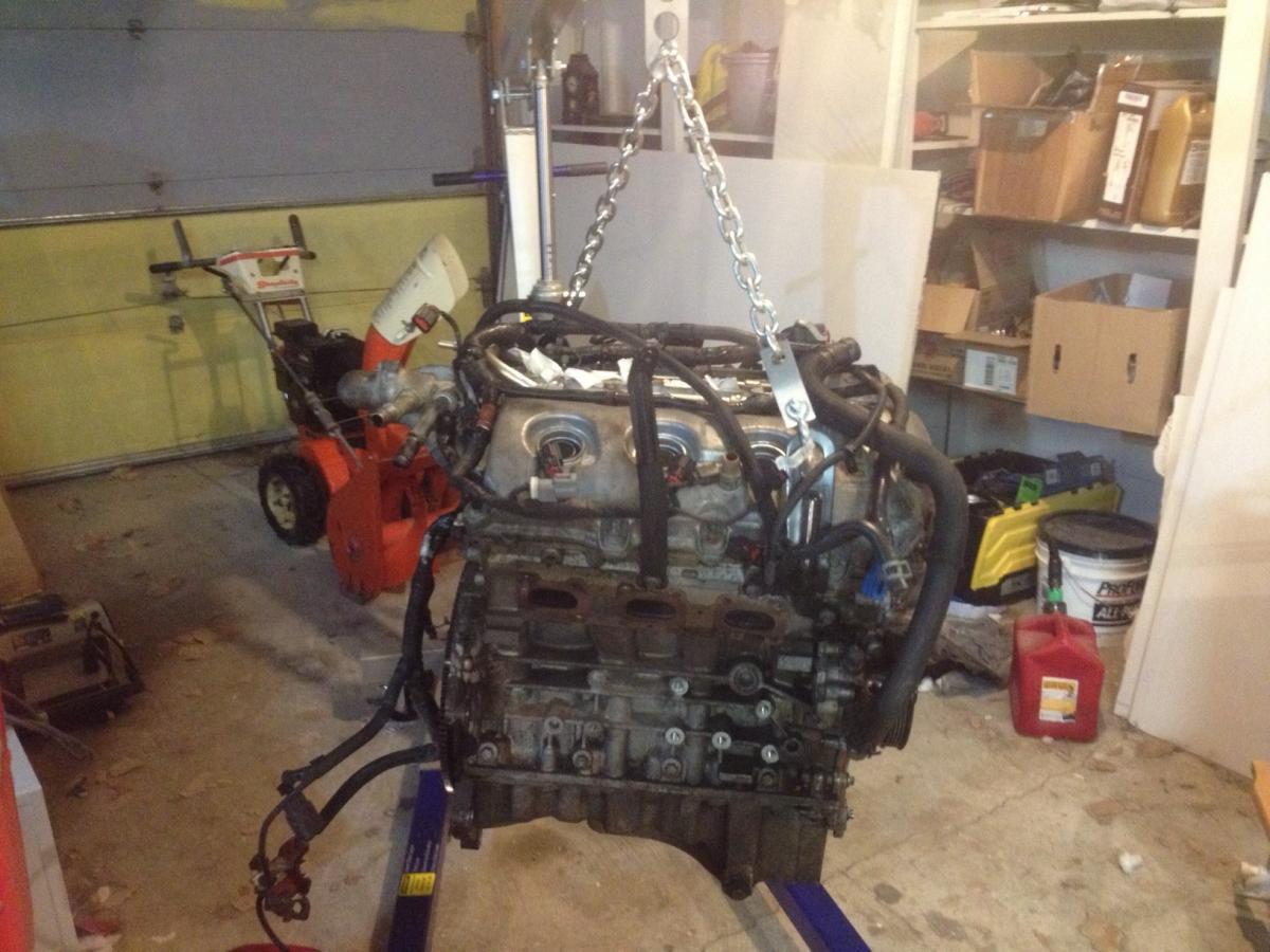

bapierce Posted January 24, 2015 Author Report Share Posted January 24, 2015 Got the engine out. Was more of a PITA than I expected, but was able to pull it through the top. Looking through the intake and exhaust ports, the valves look fine. And looking down through the spark plug hole the cyclinder looks good. I'll tear it apart and hopefully find out what happened. 1 Quote Link to comment Share on other sites More sharing options...
WWWPerfA_ZN0W Posted January 24, 2015 Report Share Posted January 24, 2015 Where was the max effort expended? Unhooking the trans & sensors? Quote Link to comment Share on other sites More sharing options...

bapierce Posted January 29, 2015 Author Report Share Posted January 29, 2015 there's an engine support bracket on the far side of the engine. The bolts on that were really hard to get to. I had to pull the passanger side drive shaft out to get to them and it was still a pain. If you remove the rear exhaust manifold cat they would be easy to get to but it's also a pain to get to the backside nuts that hold it on. 1 Quote Link to comment Share on other sites More sharing options...
