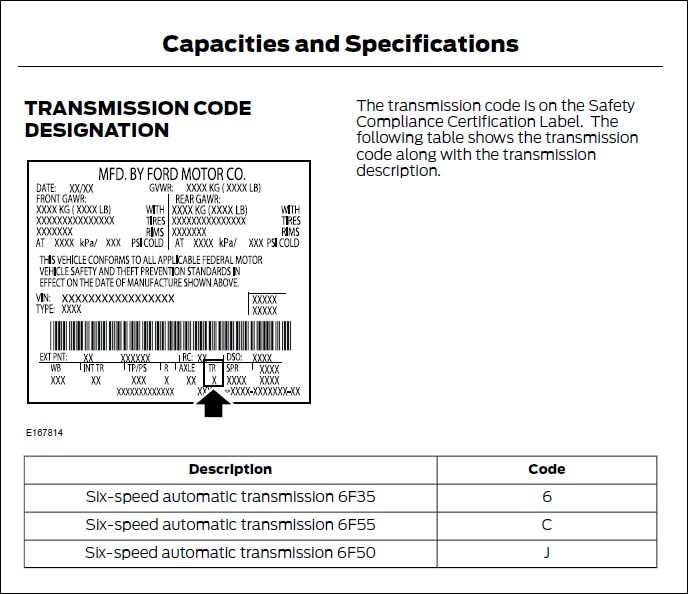

cds71 Posted February 9, 2015 Report Share Posted February 9, 2015 (edited) Thanks for the info omar32 Sweet.....the order code on my 2015 sports trans is 44c.....guess the " c " was the 6f55.......i knew they would need the heavier trans with 350 ft-lbs of torque. Edited February 9, 2015 by cds71 Quote Link to comment Share on other sites More sharing options...
omar302 Posted February 9, 2015 Report Share Posted February 9, 2015 Thanks for the info omar32 Sweet.....the order code on my 2015 sports trans is 44c.....guess the " c " was the 6f55.......i knew they would need the heavier trans with 350 ft-lbs of torque. Actually, due to the 6F55 torque limitation (though it is still higher than the 6f50), it seems that the 2.7 is like the 3.5 Ecoboost where they have both been limited to 350 lb-ft of torque while in the F-150, the 2.7 is rated for 375 lb-ft & the 3.5 is rate for 420 lb-ft (and up to 460 in the 15' Navigator). Quote Link to comment Share on other sites More sharing options...
