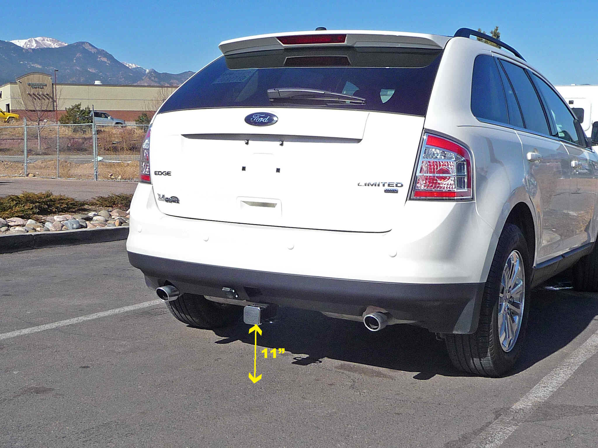

Lex Talionis Posted February 5, 2008 Report Share Posted February 5, 2008 Just got the hitch today from realtruck.com.... pretty fast ship as it is clearly a drop ship item direct from Curt. Quality looks like nice (welds, paint job, supplied hardware) and it feels stout. BTW, there is a good coupon out there for 8% off = SJ921 used at checkout at realtruck.com, save you some extra coin as they were the cheapest I found it - except for 1 guy on eBay but he has not listed any recently. now.. all I need is the car Quote Link to comment Share on other sites More sharing options...

Lex Talionis Posted February 21, 2008 Report Share Posted February 21, 2008 (edited) Installed mine yesterday. It was a solid 1.5 hours (contrary to some sites saying 45 minutes) having never done it but pretty mechanically inclined & a bitchen set of tools. a real knuckle buster. taking the muffler down was the real - tip: use WD40 on the rubber muffler mounts to slick it up to slide them out as you have 3 to remove and drop the muffler. also, be prepared to drill into your frame rail twice for the 3rd bolt (have a nice sharp 1/2 bit). also, have sheet metal shears to cut the heat shields. Edited February 22, 2008 by Lex Talionis Quote Link to comment Share on other sites More sharing options...

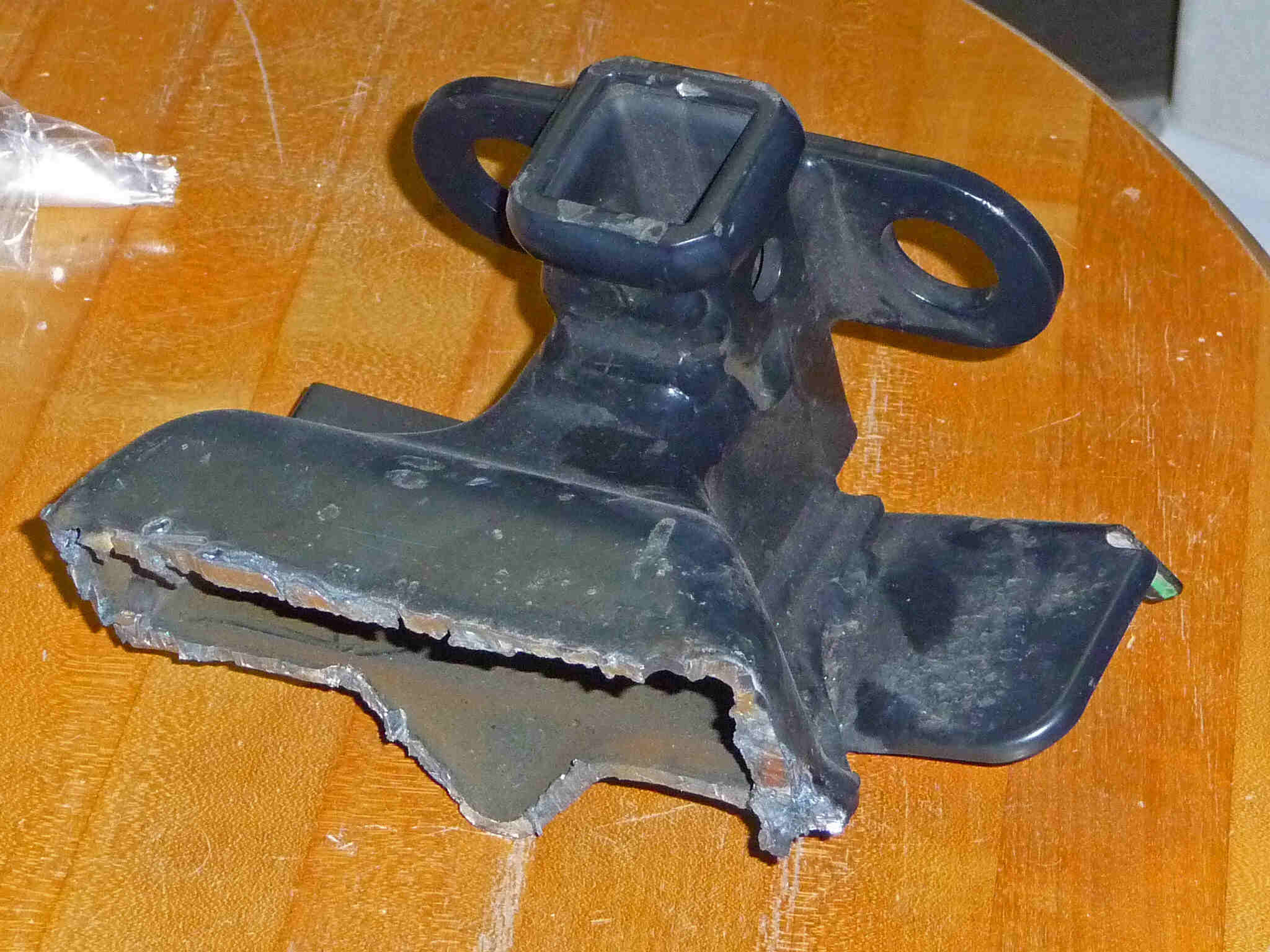

PSUFetch Posted March 12, 2009 Report Share Posted March 12, 2009 I've got a 2008 Edge with the factory tow package and I've been looking to upgrade to a class III as well. It looks like you could have saved yourself some money by not having the shop cut off the factory Class II hitch. According to Curt's website, the 13060 will fit beneath the OE 1.25" receiver. Your pictures seem to back this up as well. I haven't had a chance to really look underneath the rear of the car to see if this is possible though. I'm planning on getting a class III hithch because I'm going to be using a weight distributing system on my trailer and they all need a Class III receiver. From what I've seen here, the Curt seems to have the best quality. I think I'm going to try installing it without removing the factory hitch and see what it looks like, or if it's even possible. I'm also goingot be installing a brake controller this weekend. I'll be sure to take pictures along the way and post a how-to when i'm done (assuming I don't run into any problems ) Quote Link to comment Share on other sites More sharing options...
