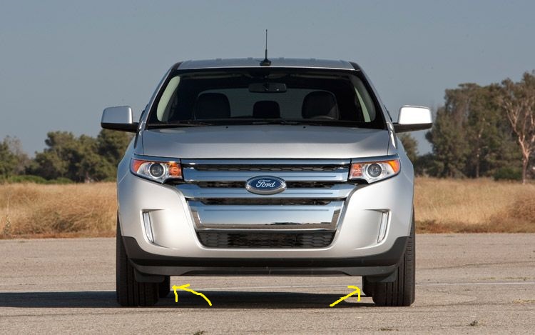

Can you tell from the picture whether I have "front fender extensions" ... not sure I know what they are!?
Yes, it appears you have the fender extensions. See attachment below where I circled.
I also included a stock image with a front view.
