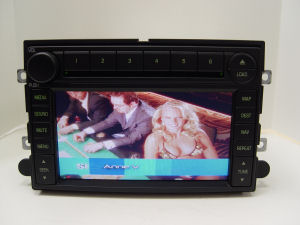

skimaniaz Posted May 1, 2008 Report Share Posted May 1, 2008 (edited) I am also interested in the back up camera for the Factory Nav Unit. Reading through the forums I found a link to an interface that works with the Ford Edge. The web site says to call for pricing, so I did. It is 250.00 for a two input (1 camera and 1 other .. DVD, computer, etc.) and you have to send the unit to them and pay 75.00 for the upgrade. (325 total) They stated they had a 1 day turn around. Sounded like they knew what they were doing on the phone. Also of note: The NAV unit is touch screen but when you update it you don't get to use the touch screen for a computer. Still works for factory unit. http://avelectronic.com/NavigationVideo%20...0Interface.html Also FYI they told me that the dealerships use their company alot and the price can be put in the financing when you buy the car. If I had known that I would have done that!! Love the 0% loan!! So I am debating on doing it and will probably wait until I save up a bit of money. I will post how it goes. PS they have a multi input for 550.00 and 75.00. Photo: http://www.avelectronic.com/GalleryPics/Fo...ury_Lincoln.jpg Edited May 1, 2008 by skimaniaz Quote Link to comment Share on other sites More sharing options...
Lex Talionis Posted May 1, 2008 Report Share Posted May 1, 2008 (edited) ....send the unit to them and pay 75.00 for the upgrade. (325 total) plus insured shipping both ways on a heavy item and time to remove/install the nav unit. these ideas of removing your nav unit and sending it in has potential, but maybe 1 in 100 people would actually make that effort. but good resource to add as an option I got to thinking.. if you have the skill to remove the nav unit and send it in, why would you not have the skill to then do the same wiring they are able to do? why can only they do it and not us? ANSWER: I was told it was because it took real solid soldering skills on the flat motherboard. so they only do it. Also, here is an interesting photo I found while web snooping on the topic that shows the stand alone unit from a 2007. I got an email in to these guys - well, it seems they want $450 to do it and you also need to send in unit. Edited May 2, 2008 by Lex Talionis Quote Link to comment Share on other sites More sharing options...
skimaniaz Posted May 2, 2008 Report Share Posted May 2, 2008 plus insured shipping both ways on a heavy item and time to remove/install the nav unit. these ideas of removing your nav unit and sending it in has potential, but maybe 1 in 100 people would actually make that effort. but good resource to add as an option Very true!! Does the unit weigh alot? Hadn't thought that part through. Adding up quickly!! Still have to buy a camera as well as this. I already have a car PC so I was thinking it wouldn't be too bad... now I wonder. Quote Link to comment Share on other sites More sharing options...

Lex Talionis Posted July 23, 2008 Report Share Posted July 23, 2008 (edited) tvandnav2go.com now lists a NEW option for 2007 Ford nav systems (so I would assume also 2008) to attach a camera and use the factory nav.. I have an email in to get more data - cost, difficulty of install and can it be self installed. will report back. but it essentially looks like they now have a system you can install to the nav motherboard versus sending to them to have installed?? hard to say just yet as the have some new photos not there before. not sure if they are implying, as they do not say, this is still only installed by them when you send in unit or you can do it yourself now as that "new" reference and the photos are newer. UPDATE: it appears they do have a newer system and it can be used in 2008 but it still requires them to do the install. UPDATE 2: watch this thread as a new option may be released next week that is truly plug-n-play from the guys mentioned in post #9 Edited July 24, 2008 by Lex Talionis Quote Link to comment Share on other sites More sharing options...
