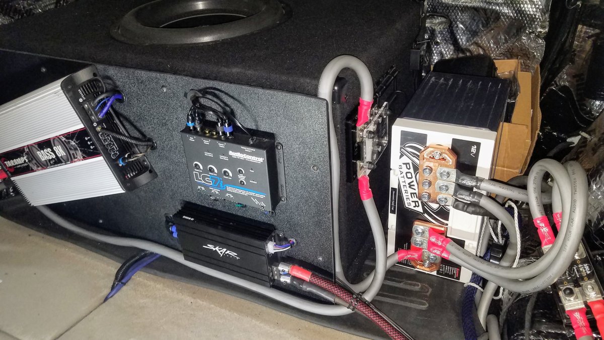

EdgeOn Posted December 26, 2020 Report Share Posted December 26, 2020 (edited) I have EXACT same issue with my front driver's door, but includes an annoying subtle somewhat of a whistling noise from the top corner next to my ear when driving in excess of 45 mph. 2011 Ford Edge SEL Black 130K. I'm going to attempt to adjusting striker plate considering the seals appear to still be like-new around all doors. (although I don't think the striker plate holes are adjustable, I believe they are just large enough for the bolts to fit thru., as in, no room to slide striker in closer to frame.) In that case, only thing I can think of doing will be to enlarge seals whether by replacing with new or filling them with either surgical tubing or foam rope. Right? [Please ignore the cardboard box that temporarily was sitting behind the XS Power Super Bank Capacitor Battery SB1500-75 at time of taking photo] DEC 2020 will be the last month of having this car audio system build set-up because I'm upgrading from 1 Skar DNR 15" 5K RMS w/ Taramps Bass 8K @ 1-ohm.. to.. 2 Fi Neo 4.11 15"s w/ 2 Taramps Bass 8Ks but at 0.7-ohm all lithium batts equating to 20,000 RMS Watts!! Yes I'm a Car Audio Basshead Fanatic. See videos of past and current builds on my YouTube channel: Brandon Lee Edited December 26, 2020 by EdgeOn added info about photo Quote Link to comment Share on other sites More sharing options...
