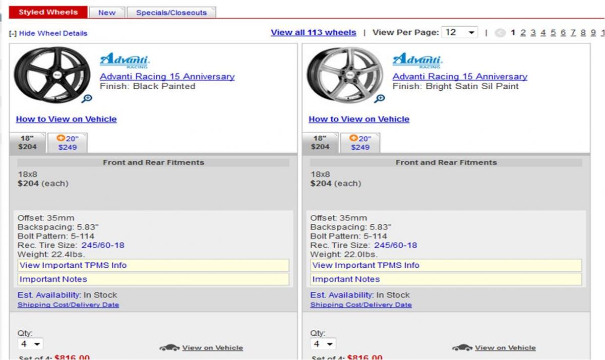

akirby Posted October 21, 2014 Report Share Posted October 21, 2014 If you had followed my directions and put in your vehicle on tirerack.com you'd see that the factory wheels are 18" x 8" with a 35 mm offet and 5.8" backspacing and a 5-114 lug pattern. So you want 8" wide wheels with a 35mm offset, 5.8" backspacing and a 5-114 lug pattern. Quote Link to comment Share on other sites More sharing options...

akirby Posted October 21, 2014 Report Share Posted October 21, 2014 http://www.tirerack.com/wheels/results.jsp?filterSize=18&filterFinish=All&filterBrand=All&filterWeight=All&autoMake=Ford&autoModel=Edge+SEL&autoYear=2010&autoModClar=FWD&sort=Brand&filterNew=All&filterSpecial=false Shop for wheels. Put in 2010 Ford Edge SEL FWD. Filter on Tire Diameter - 18" OE. Bingo. Quote Link to comment Share on other sites More sharing options...

akirby Posted October 22, 2014 Report Share Posted October 22, 2014 And I'm not sure what you're not seeing. The backspacing and offset are clearly shown on each wheel and tirerack says these wheels will fit the Edge. If you want your aftermarket 18" wheels to fit the same way as the stock OEM 18" wheels then you need to find ones with similar width, offset and backspacing to the ones shown. I can't make it any clearer. Quote Link to comment Share on other sites More sharing options...
