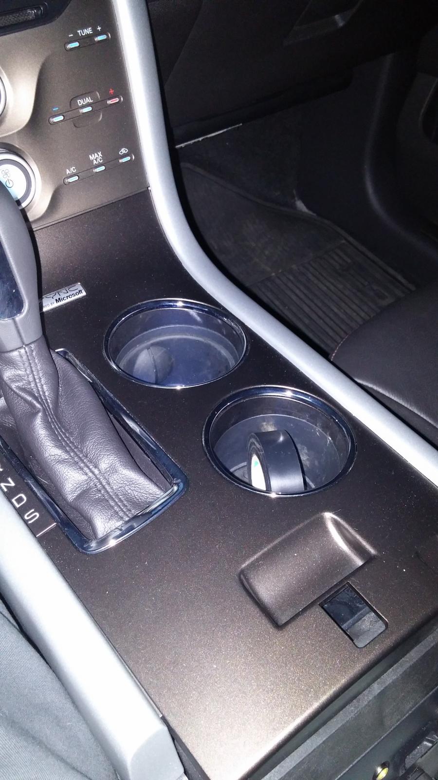

Dominatron2212 Posted November 25, 2014 Report Share Posted November 25, 2014 How did you do the lit cup holders? Quote Link to comment Share on other sites More sharing options...
snake456 Posted November 27, 2014 Author Report Share Posted November 27, 2014 Dominatron - I just used a strip of 3 blue leds you can purchase at any Auto Zone. Pulled the silver trim pieces on each side of the center console, unscrewed the shifter cover and tapped into the wire for the shifter selector light and drilled holes through each cupholder and stuck the lights to the inside of the cupholder. Make sure that when you place the lights in the cupholders you put them at about 7:00 position so they don't shine in your eyes at night. Hour job at most. Cost about $20 total. Quote Link to comment Share on other sites More sharing options...

jjones0377 Posted November 27, 2014 Report Share Posted November 27, 2014 Do you have to picture of the lights in the cup holder you could post? Would like to see it. Quote Link to comment Share on other sites More sharing options...
snake456 Posted December 2, 2014 Author Report Share Posted December 2, 2014 (edited) Here you go. Pic of cupholder lights. The pic is taken from the glove box angle. Remember to place lights at 7:00 position to avoid them shining in the driver's eyes. Ā Edited December 2, 2014 by snake456 Quote Link to comment Share on other sites More sharing options...
