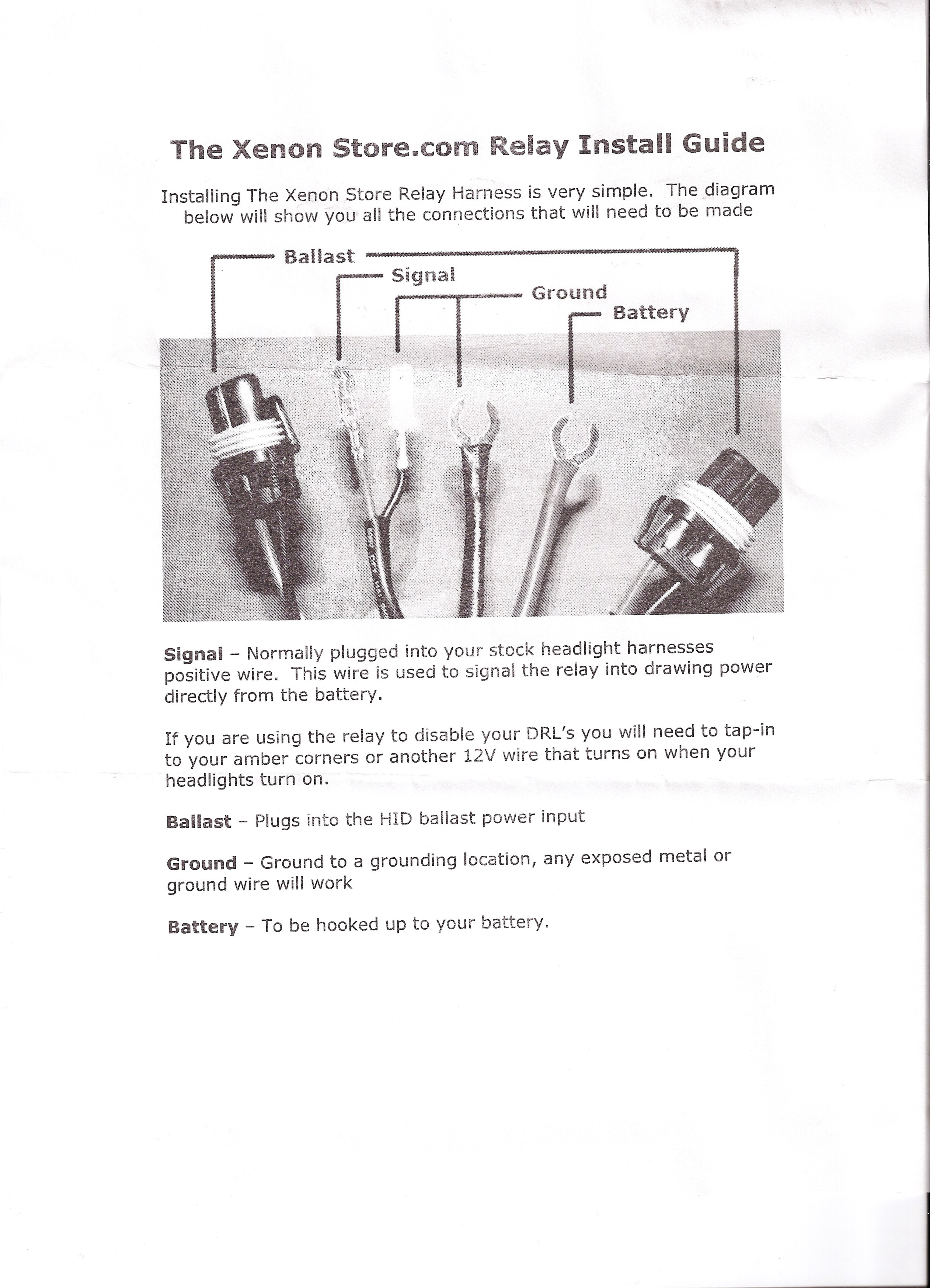

hi:
Can you post couple of photo to show how to connect relay and hid set? I have attached the install guide, but i am not sure where i should connect the signal and two ground line!
Thanks!
Edited by fly6

The reason I'm asking about the direct connection is that Ford uses high-side FET (field-effect transistors) to control each headlamp bulb. Solid-state controls like this are usually designed to control resistive loads, such as filament bulbs like halogens. Inductive loads such as ballasts and transformers can destroy solid-state devices if they're not protected by shunt diodes. Maybe those are included in the ballasts you have, since they seem to work.
I talked to a Ford electronics engineer who said that the headlamp output in the Edge (and in many Fords using the same Smart Junction Box) is actually a PULSED +12V, not continuous, to help increase halogen headlamp life (and to allow for DRL control by varying the pulse sizes). Pulsed outputs, combined with an inductive load, could spell trouble for the headlamp controls if used directly with cheap aftermarket HID ballasts, or even with relays. Also, inrush current (the current that a load draws when first switched on) may be HIGHER with ballasts, even if the normal operating current is lower. THAT could also destroy the headlamp control FET.
But the real thing to worry about here is the Smart Junction Box, since the headlamp control circuits are non-replaceable parts built into it as one box (which controls much of the electronics). If you fry the headlamp outputs, you'll need an entire new SJB, and that could cost almost $1,000. I'm also guessing that Ford could determine the cause of an SJB failure, and deny a warranty claim.
Those are just a few things that people should consider here before trying an HID kit. Since I have a lot of experience with FETs and other solid-state controls (and what cheap inductors can do to them), I think I'll pass on aftermarket HID for now, unless I hear something different from that Ford engineer.
Just a warning...remember that if you fry your headlamp circuits, you'll need an entire Smart Junction Box to get them working again.
