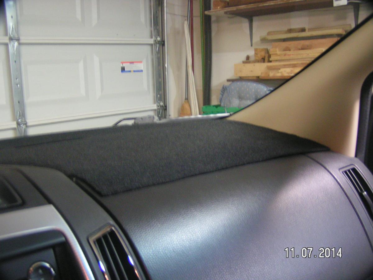

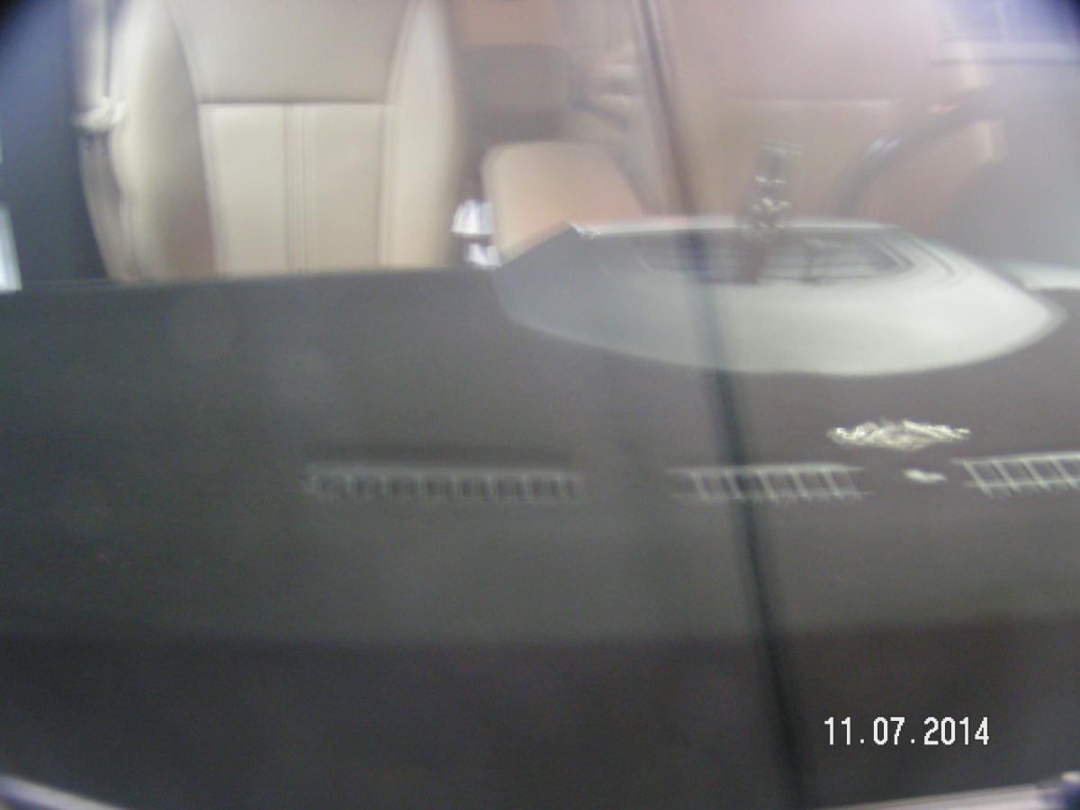

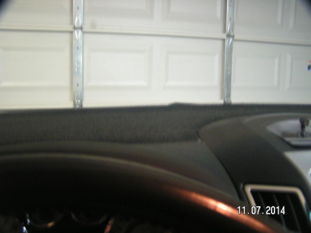

Platinum White Posted November 7, 2014 Report Share Posted November 7, 2014 (edited) I made a pattern of the dash back to the dash seam on the drivers side and cut a black fabric for the dash. Cut out holes for the defroster and headlight sensor from the pattern. Tuck one edge between the windshield and the dash and work the sides down between the A pillar and dash. Result = no more reflection off the dash in the windshield. Worked for me. Edited November 7, 2014 by Platinum White Quote Link to comment Share on other sites More sharing options...
PaulSchott Posted November 9, 2014 Report Share Posted November 9, 2014 Looks nice, I think it will just blow out of the way if the airbag deploys. Quote Link to comment Share on other sites More sharing options...
