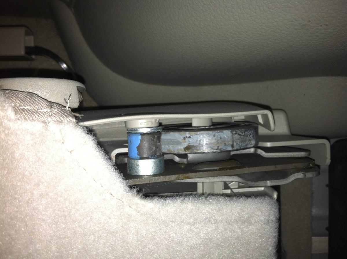

Since the last winter my street has been falling apart with pot holes and really crappy repair patches. My route to work has also been torn up getting ready for a repave for the last 2 weeks. Over this last couple of weeks I have been noticing a really annoying rattle creek coming from the rear of the car. I moved all the stuff around under the rear cover and organizer. No improvement found. Sunday I was cleaning up the rear seat area and I bumped the passenger side rear seat back and recreated the noise. Upon further banging I found that the release handle when partly pulled stopped the noise. I siliconed the release hinge and the noise stopped. Picture included.

Its funny that you mentioned this, I had the same rattle ticking sound and I also pinpointed it at this same location. Mine is coming from the passenger back seat, when I bang the bottom of the seat I can replicate the noise. I just folded and slammed shut the seat in place and noise went away. Looks like I need to invest in some silicone spray with this vehicle. This is an extremely noisy vehicle when it comes to the interior, I am constantly battling with interior noise and my vehicle only has 17k on it
