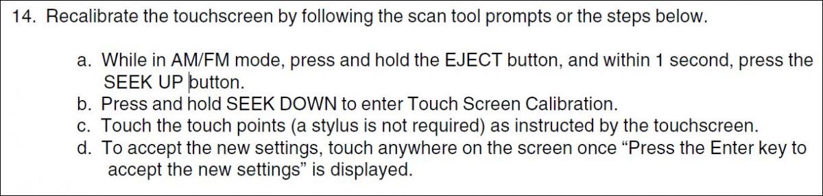

omar302 Posted September 30, 2014 Report Share Posted September 30, 2014 (edited) You should not need to calibrate the screen. I suggest taking it back to the dealer. But, since this is a forum with DIY advise, try the calibration menu in the diagnostic mode. To enter MyFord Touch into diagnostics mode: - Make sure there is no CD in the system - Set MFT to AM/FM - Press and hold the eject button and... - Immediately after press and hold the right arrow on the center wheel while still holding the eject button - Hold both buttons pressed for about 12 seconds - Screen goes black and MFT enters diagnostics mode The system defaults to a speaker tone test which starts immediately. You can cancel it on the screen. You should find a screen calibration entry (don't remember it exactly), after finishing, tap anywhere on the screen to exit. Edit: Found the below screenshot, don't remember were I got it from! Edited September 30, 2014 by omar302 2 Quote Link to comment Share on other sites More sharing options...

Shadrack Posted October 10, 2014 Author Report Share Posted October 10, 2014 Update: Instead of going through the hassle of setting up a dealership visit for something simple as this, I decided to give the calibration a try myself. No offense to dealerships, but honestly, I trust myself over most of my local dealerships. Anyways, I went though the on screen instructions, straightforward as you could get. Recalibrated my touchscreen, and it works perfectly now! Thanks for the information omar302! 1 Quote Link to comment Share on other sites More sharing options...
