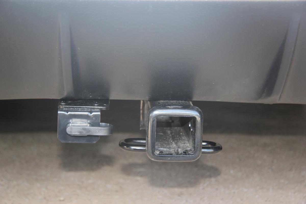

Lunareclipse02 Posted September 11, 2014 Report Share Posted September 11, 2014 I am looking in purchasing a hidden style hitch. But all types require you to tuck in the center bumper brace inside the bumper. I really want the look of a hidden hitch but afraid the bumper will be flapping in the wind due to removing the brace. Can anybody give me their experiences with your hitch and removing the bumper brace. Thanks Quote Link to comment Share on other sites More sharing options...
rwf78155 Posted September 11, 2014 Report Share Posted September 11, 2014 (edited) I had a hidden Hitch brand hitch installed on my Edge Sport last week (It was backordered over a month for the SPORT) Yes the center brace is tucked inside the bumper. Good new is...no detectable rattling and cannot tell that it is not connected to the bumper....The rear bumper is still firm all the way across ! btw...the Hidden Hitch was definitely worth the wait....the only thing showing is the square hitch tube, tail light plug, and the chain hooks! Edited September 11, 2014 by rwf78155 Quote Link to comment Share on other sites More sharing options...
factor99 Posted September 11, 2014 Report Share Posted September 11, 2014 I will second rwf on this. I think it is actually stiffer with the hitch installed as the bumper sits on the hitch. Quote Link to comment Share on other sites More sharing options...

Uncoiler Posted September 13, 2014 Report Share Posted September 13, 2014 I too was concerned about the bumper fluddering in the wind at high speed without that factory bracket screwed in. Ford put a bracket there for a reason? Anyway I wanted a hidden hitch no matter what so I thought when installing it, I will see if there is anything I can do to help compensate, as opposed to just leaving it there unattached. This was months ago now when I installed it, but I beleive I ended up attaching a plastic tie strap through the screw hole in the bracket, and wrapping the strap around part of the hitch. Essentially the bracket is now fixed to the hitch "so to speak" and very secure just as if it was screwed into the car frame. If the plastic strap breaks at some point (it ain't gonna last forever) it's easy to just wrap another strap around it. As others have mentioned I likely didn't need to do that, but it only took an extra minute to do and gave me some piece of mind. 1 Quote Link to comment Share on other sites More sharing options...
Lunareclipse02 Posted September 13, 2014 Author Report Share Posted September 13, 2014 Thanks for your input Uncoiler. Did you use a ziptie? I may just do this also when I install or pay someone to do it for me. I am a kinda of person who is better safe than sorry. Quote Link to comment Share on other sites More sharing options...
rwf78155 Posted September 13, 2014 Report Share Posted September 13, 2014 I remember taking that loose bracket and forcefully wedging it against the hidden hitch so there is no way it can rattle...took a little bending to wedge it into place Quote Link to comment Share on other sites More sharing options...
