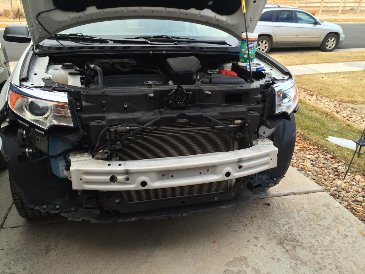

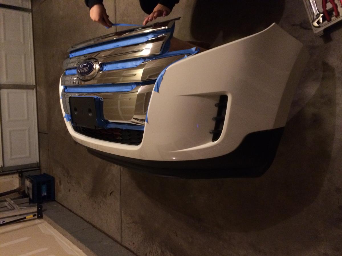

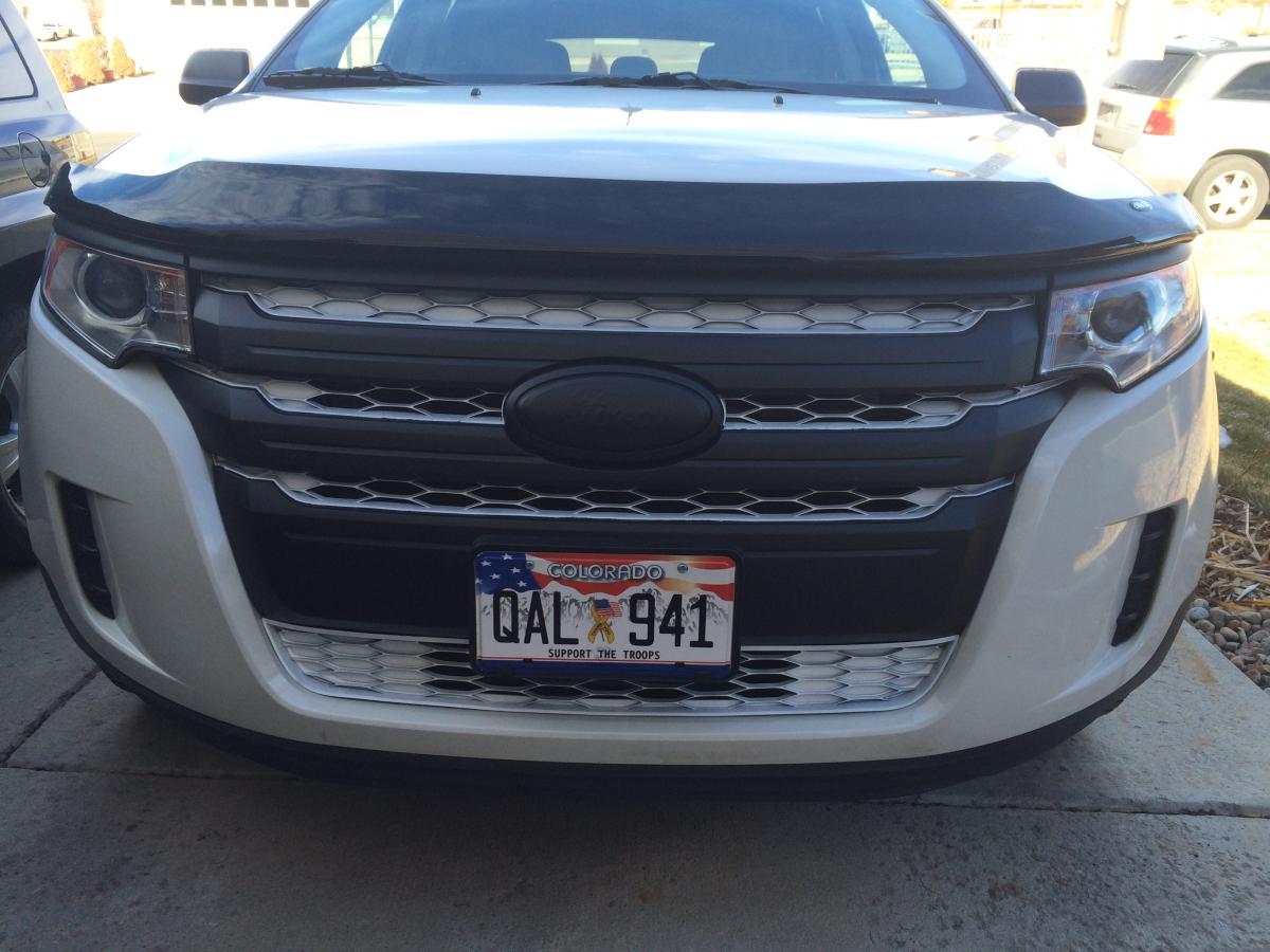

thom6998 Posted January 18, 2015 Report Share Posted January 18, 2015 I finished my plasti dip project this weekend. I easily removed the grill to spray. I'm happy with how it came out but I'm going to try and touch up the white next week. I have a car wash subscription that I use during the Winter to get the mag chloride off my car. Hopefully it holds, we will see. It feels durable and I've watched several videos of cars going through the car wash after being dipped and they were fine. 1 Quote Link to comment Share on other sites More sharing options...

thom6998 Posted February 3, 2015 Report Share Posted February 3, 2015 how did you do the emblems? did you mask them off? im assuming they are pinned into the car as they are in other ford models?I used newspaper to tape around the outside of the emblem then sprayed over it with 5 coats. After it dried I peeled the plasti out of the inside. I also did my Ford emblem and it turned out well. Quote Link to comment Share on other sites More sharing options...
Tjames557 Posted February 4, 2015 Report Share Posted February 4, 2015 I used newspaper to tape around the outside of the emblem then sprayed over it with 5 coats. After it dried I peeled the plasti out of the inside. I also did my Ford emblem and it turned out well. Ā Awesome! thank you. Ill have to give it a shot. Was it hard to keep the part you pulled out of the middle from taking the side of the emblem plasti with it? Quote Link to comment Share on other sites More sharing options...
thom6998 Posted February 4, 2015 Report Share Posted February 4, 2015 Awesome! thank you. Ill have to give it a shot. Was it hard to keep the part you pulled out of the middle from taking the side of the emblem plasti with it? No, I used a toothpick to trace the letters on the inside and it came right off while staying tight on the letters. So far driving through snow and getting dirt all over hasn't affected it at all. Quote Link to comment Share on other sites More sharing options...
