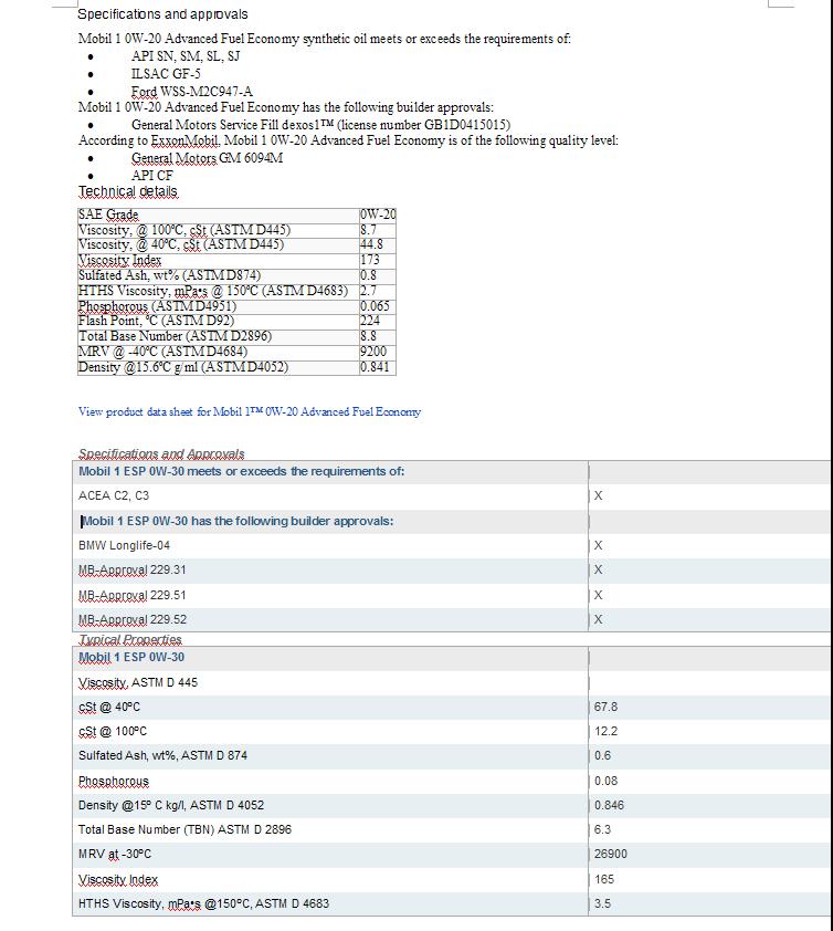

EDST777 Posted December 1, 2015 Author Report Share Posted December 1, 2015 (edited) Mobil 1 ESP 0w30 technical data info here: http://www.mobil.com/Belgium-English/Lubes/PDS/GLXXENPVLMOMobil_1_ESP_0W-30.aspx I am afraid that Mobil1 Fuel Economy 0w30 and Mobil1 ESP 0w30 have different characteristics. I am afraid that it is various oils. I am not right? What your thoughts? p.s.: And at present only Mobil1 Fuel Economy 0w30 is available to me from a line of Mobil. https://mobiloil.com/en/motor-oils/mobil-1/mobil-1-advanced-fuel-economy Specifications and approvals Mobil 1 0W-20 Advanced Fuel Economy synthetic oil meets or exceeds the requirements of: API SN, SM, SL, SJ ILSAC GF-5 Ford WSS-M2C947-A Mobil 1 0W-20 Advanced Fuel Economy has the following builder approvals: General Motors Service Fill dexos1™ (license number GB1D0415015) According to ExxonMobil, Mobil 1 0W-20 Advanced Fuel Economy is of the following quality level: General Motors GM 6094M API CF Technical details SAE Grade 0W-20 Viscosity, @ 100ºC, cSt (ASTM D445) 8.7 Viscosity, @ 40ºC, cSt (ASTM D445) 44.8 Viscosity Index 173 Sulfated Ash, wt% (ASTM D874) 0.8 HTHS Viscosity, mPa•s @ 150ºC (ASTM D4683) 2.7 Phosphorous (ASTM D4951) 0.065 Flash Point, ºC (ASTM D92) 224 Total Base Number (ASTM D2896) 8.8 MRV @ -40ºC (ASTM D4684) 9200 Density @15.6ºC g/ml (ASTM D4052) 0.841 View product data sheet for Mobil 1™ 0W-20 Advanced Fuel Economy Edited December 1, 2015 by EDST777 Quote Link to comment Share on other sites More sharing options...

WWWPerfA_ZN0W Posted December 1, 2015 Report Share Posted December 1, 2015 The Mobil1 AFE 0W30 oil should be fine to try, if you want to try a 0W30 oil. Compare the specifications for the Motorcraft 5w20 synthetic blend oil to see how close (or not) the individual characteristics (viscosity, density etc.) are. Apart from relying strictly on the Ford specification Mxxxxxx or Wxxxxxx, these characteristics will tell you if the oil is what you are looking for. Motorcraft Synthetic Blend 5W20 PDS.pdf SAE Grade 5W-20API Service GF-5/SNSpecific Gravity @ 60°F (15.6°C) 0.860Density, lb/gal 7.17Flash Point, COC, °C (°F) 206 (402)Viscosity:cSt @ 100°C 8.7cSt @ 40°C 50cP @ -30°C 5,200Viscosity Index 164Pour Point, °C (°F) <-42 (<-44) So, comparing the AFE 0W30, you see that the AFE: A] viscosity in general is higher at different temperatures, indicating better use for hotter climates (e.g., summertime in your area) B] viscosity index is slightly higher, indicating better consistency throughout the operating range C] flash point is higher, also good (more heat stable) C] pour point is lower, so will work in even lower temperatures than the Motorcraft oil In summary, I would prefer NOT to use this oil, especially in COLD temperatures, simply because of the viscosity. Would be great for HOT temperatures though. COLD temperatures, the Motorcraft oil wins. 1 Quote Link to comment Share on other sites More sharing options...
WWWPerfA_ZN0W Posted December 1, 2015 Report Share Posted December 1, 2015 Comparing the Motorcraft to the Titan product, Titan's: A] viscosity is lower, which is want for COLD temperature performance; significantly lower at -30C than Motorcraft so for this B] flash point is higher I would like to know pour point and all the other goodies that US oil specs provide, but on the surface, the TITAN SUPERSYN F ECO-B 5W-20 seems like a no-brainer. I haven't read any reviews of this oil, though, so I don't know more. Remember, it's not all about flow, it's about how well the oil protects the engine, which involves additive packs. The only tests I have seen for wear & tear are those flouted by Amsoil, and I don't know if those are impartial, being conducted by Amsoil. Not comprehensive by any means. For example: http://www.amsoil.com/performancetests.aspx A Study of SAE 5W-30 Synthetic Motor Oils (G3115) http://www.amsoil.com/international/distributor/ Looks like you should give the Titan Supersyn a go first, see how it performs. If you can find Mobil1 AFE 0W20 (ask the distributor/retailer), I'd try that as well. 1 Quote Link to comment Share on other sites More sharing options...
