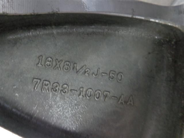

Those wheels are 1/2" wider than stock. There shouldn't be a problem with fender clearance unless you also lower your Edge. They should fit inside the fender because they have a 50mm offset to compensate for the added width but it is possible you might get some rubbing on the inside on the front at full steering lock due to the extra width. The stock 245/60-18 tires are a good fit on that wheel.
Whether it will look good is a matter of personal taste. My vote would be no, there are much nicer wheels to go on the Edge (or on the Mustang for that matter) but my opinion doesn't matter... it's whether you like them or not.
