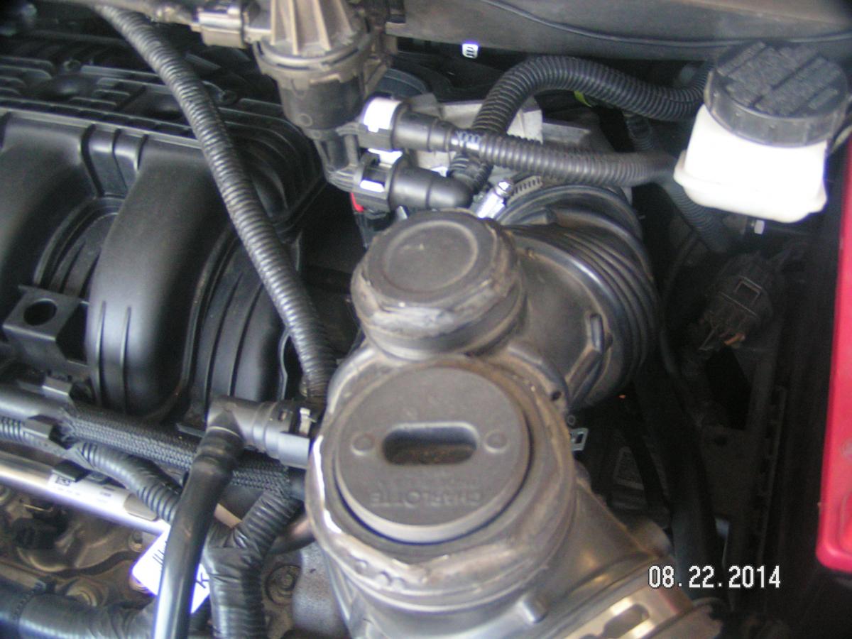

Platinum White Posted August 17, 2014 Report Share Posted August 17, 2014 (edited) You do not have to cut the clamps, just work the muffler box out of the holes and plug them with the appropriately sized PVC plugs. This is how I did it. Edited August 22, 2014 by Platinum White Quote Link to comment Share on other sites More sharing options...

sixponies Posted August 29, 2014 Report Share Posted August 29, 2014 Air Intake.JPGYou do not have to cut the clamps, just work the muffler box out of the holes and plug them with the appropriately sized PVC plugs. This is how I did it. What size plugs did you use? 1 Quote Link to comment Share on other sites More sharing options...
