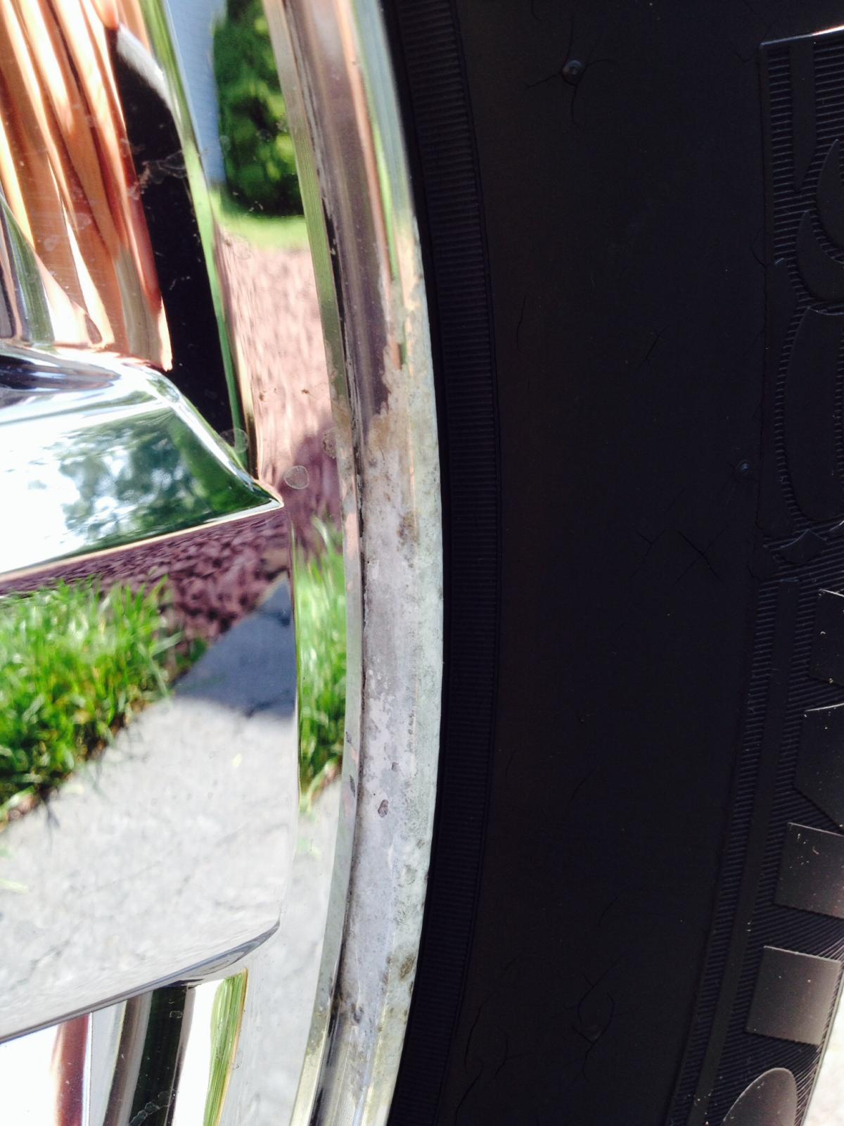

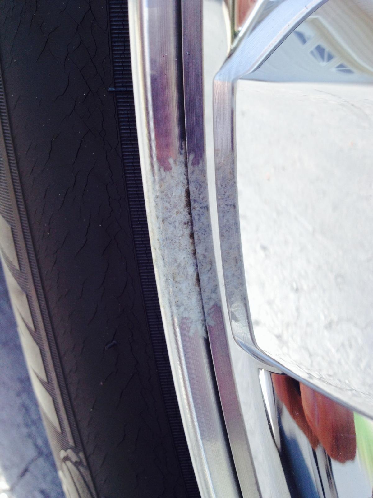

exhdo1 Posted July 8, 2014 Report Share Posted July 8, 2014 I have a 2010 Edge SEL with the chrome clad wheels. I am having an issue with the wheel itself (not the chrome coated plastic part). The edge of the rim has begun to develop rust spots. I tried a mild chrome cleaner with no results. Just wondering if anyone has a similar issue with their wheels, and if you do, what was the fix if any. I included a couple of photos that may help. Thanks. Quote Link to comment Share on other sites More sharing options...

WWWPerfA_ZN0W Posted September 30, 2014 Report Share Posted September 30, 2014 Looks like the issue may run deeper than the visible portion. Normally, scouring with steel wool (#0000 variety) would be warranted, followed by primer & wheel paint. You could try Meguiar's 205 also (a fine/final stage polishing agent) instead of the steel wool to see if it helps. Quote Link to comment Share on other sites More sharing options...

Waldo Posted October 1, 2014 Report Share Posted October 1, 2014 There is a TSB out for this; 12-13-8. It basically puts a chrome plastic trim ring over the edge of the wheel. Quote Link to comment Share on other sites More sharing options...
PaulSchott Posted October 1, 2014 Report Share Posted October 1, 2014 You should really take a close look at your tires. The first photo shows a lot of cracking. Quote Link to comment Share on other sites More sharing options...
