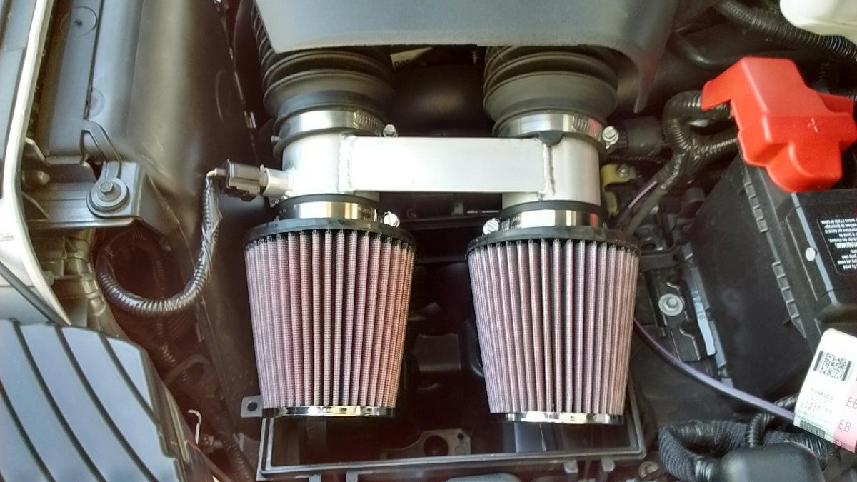

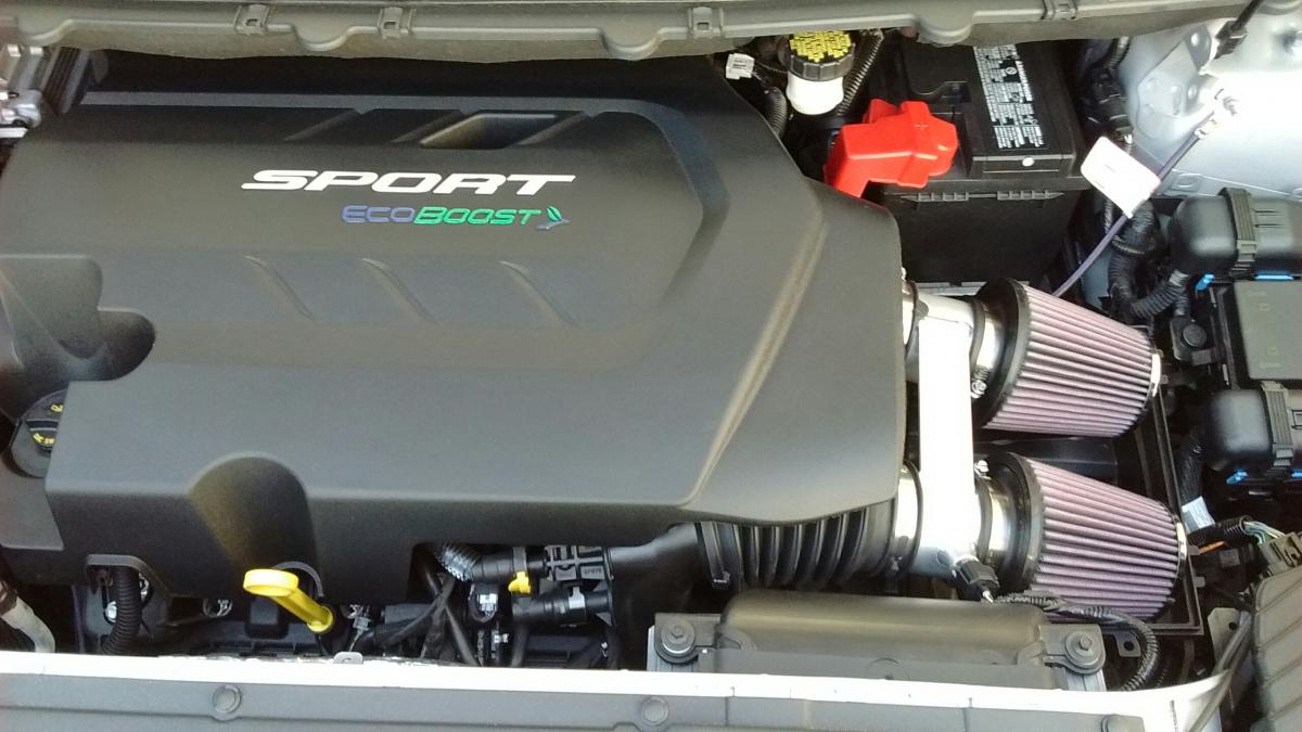

Anyone running a Cold Air Intake?
traxiii
Just noticed a air filter thread in the Mods. folder, so if the moderator wants to take this down, I'm fine with that.
K&N says their CAI makes 5+ horsepower and an increase in mileage. Has anyone here installed one?
