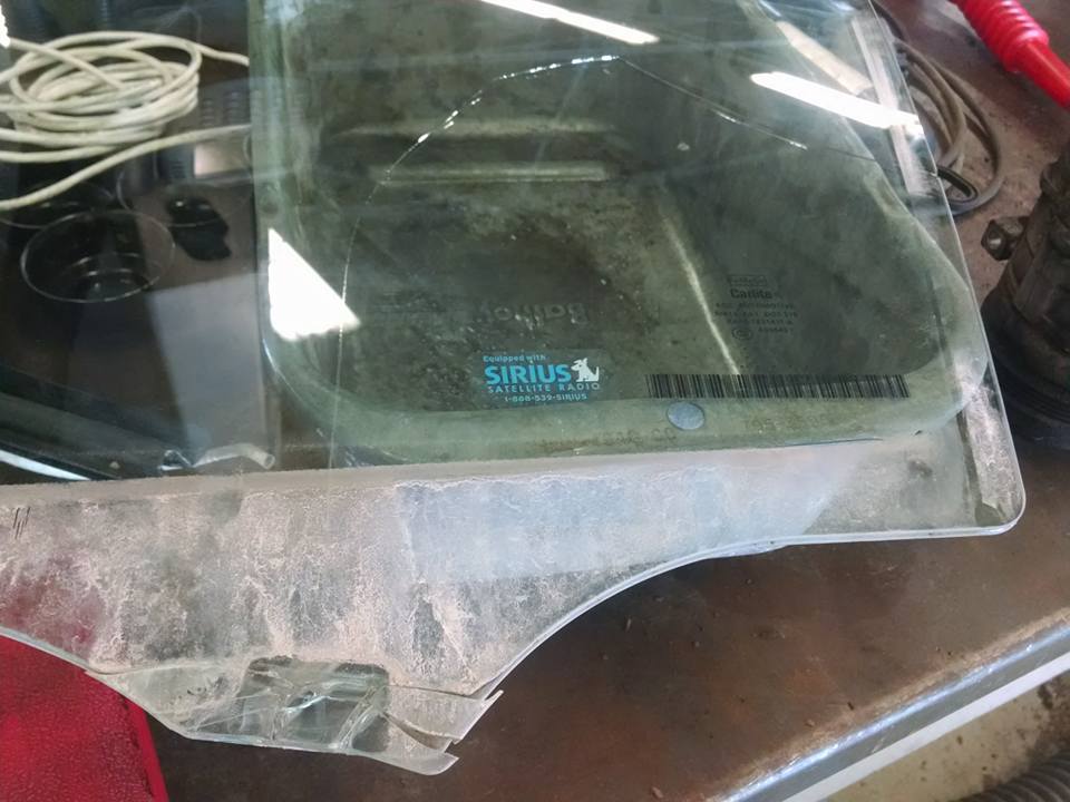

macbwt Posted July 16, 2016 Report Share Posted July 16, 2016 This is what Ford did to the window when they installed it. 1 Quote Link to comment Share on other sites More sharing options...
CinnamonEdge Posted July 17, 2016 Report Share Posted July 17, 2016 Im sure they wouldnt install it like that. but the design is weak . Its like holding a glass with a pair of pliers. I'm scared to close my doors now. 1 Quote Link to comment Share on other sites More sharing options...

macbwt Posted August 1, 2016 Report Share Posted August 1, 2016 No doubt Ford broke the window during installation. 1 Quote Link to comment Share on other sites More sharing options...
