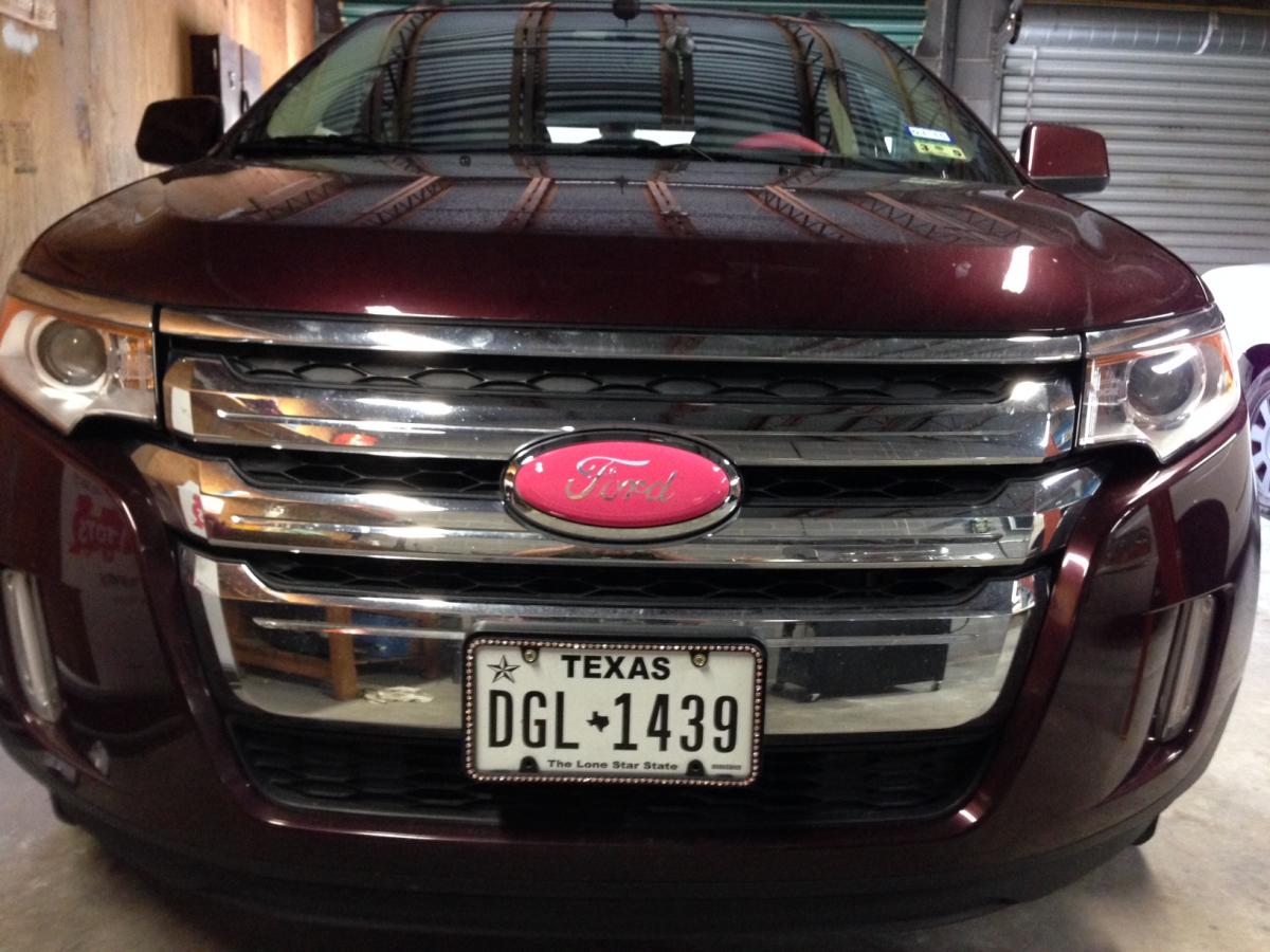

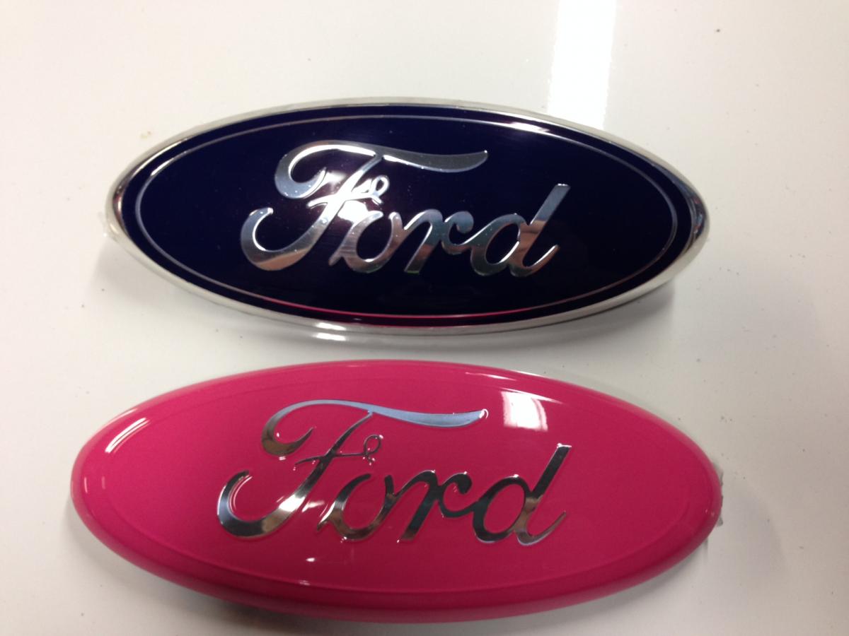

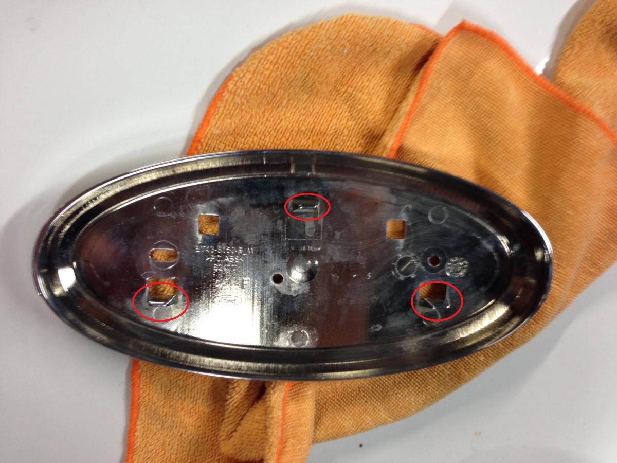

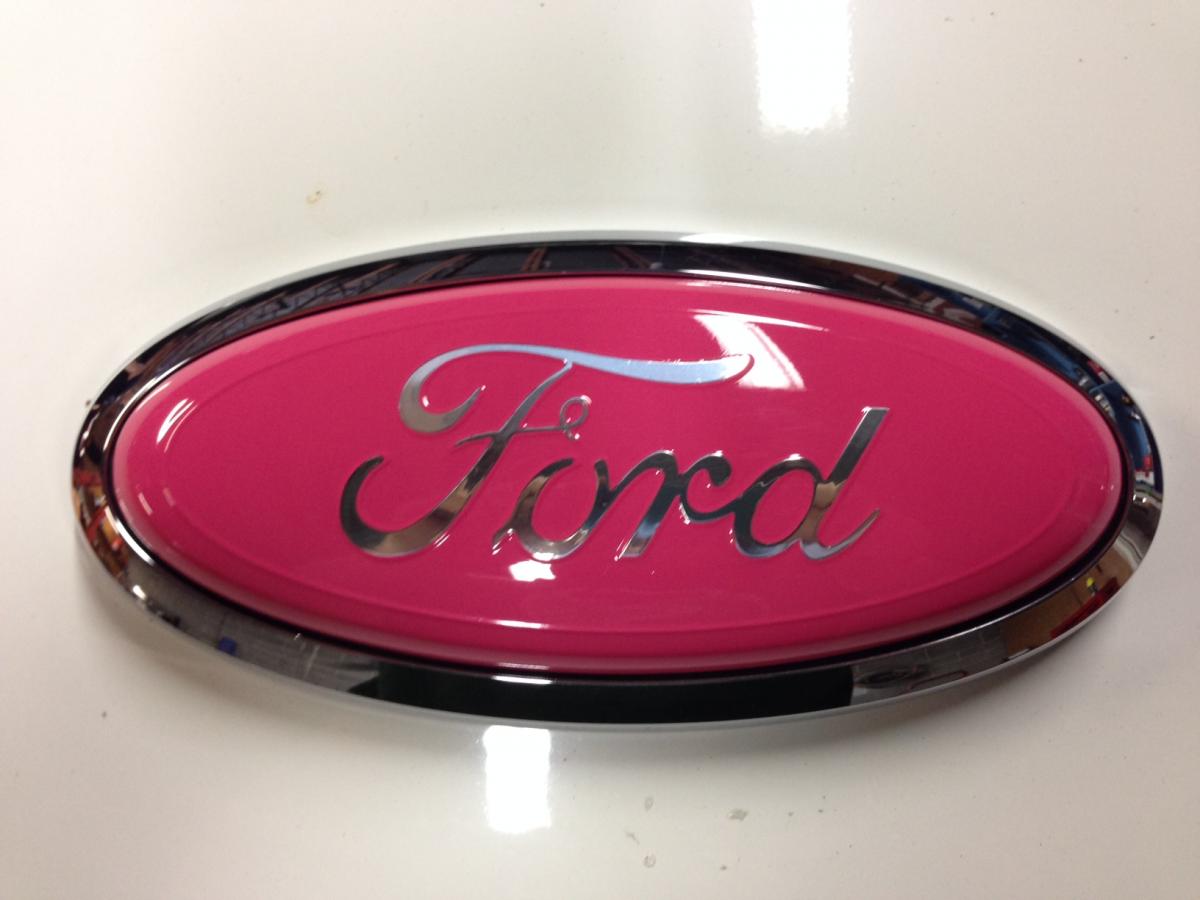

strike2tamu Posted May 13, 2014 Report Share Posted May 13, 2014 (edited) Here is how I removed the front emblem on my wifes 2011 Ford Edge SEL. First remove the (2) 10mm screws and 4 clips located on the top of the shroud. Marked with red circles are the things that need to be removed. Then gently pull back the shroud in the direction of the yellow arrows, do not go to far, just enough to get you hand in the hole in the center. You are reaching in and unclipping the three points on the trim piece that actually holds the emblem in place. They are circled in red in the picture below. (You can probay just use a 10mm socket and take the two nuts of the emblem, I didnt try this because it was much easier to just push the tabs down and unclip it) After you have removed the emblem and trim (if thats the way you did it) you simply unbolt the emblem from the trim using a 10mm socket. The rest I am sure you can figure out, to replace just reverse the order of course. Pics below. Edited May 13, 2014 by strike2tamu Quote Link to comment Share on other sites More sharing options...
BPM Posted May 14, 2014 Report Share Posted May 14, 2014 Where did you get the new emblem? Quote Link to comment Share on other sites More sharing options...
strike2tamu Posted May 18, 2014 Author Report Share Posted May 18, 2014 Where did you get the new emblem? https://www.etsy.com/listing/174343181/custom-ford-emblem-pink-with-chrome-2004?ref=market Quote Link to comment Share on other sites More sharing options...

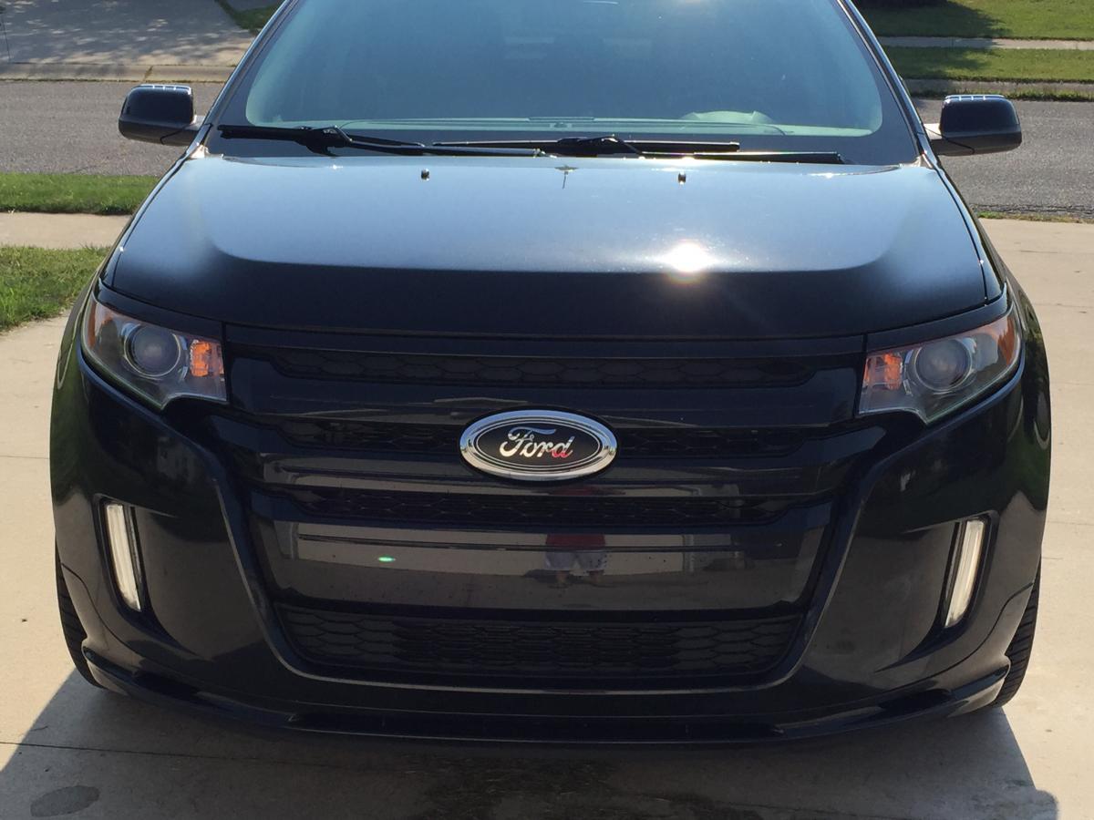

Swood73 Posted December 19, 2014 Report Share Posted December 19, 2014 Nice Write up Strike2tamu. Exactly how I figured it out as well. I used a long paint stirring stick to reach and release the lower tab. I replaced my wife"s emblems witha set from Brent over at http://www.customtrucksolutions.com/apps/webstore/ My wofe chose the colors and I ordered. Brent has great customer services and replaied to my questions immediately. Thought I would share some photos. Thanks 3 Quote Link to comment Share on other sites More sharing options...

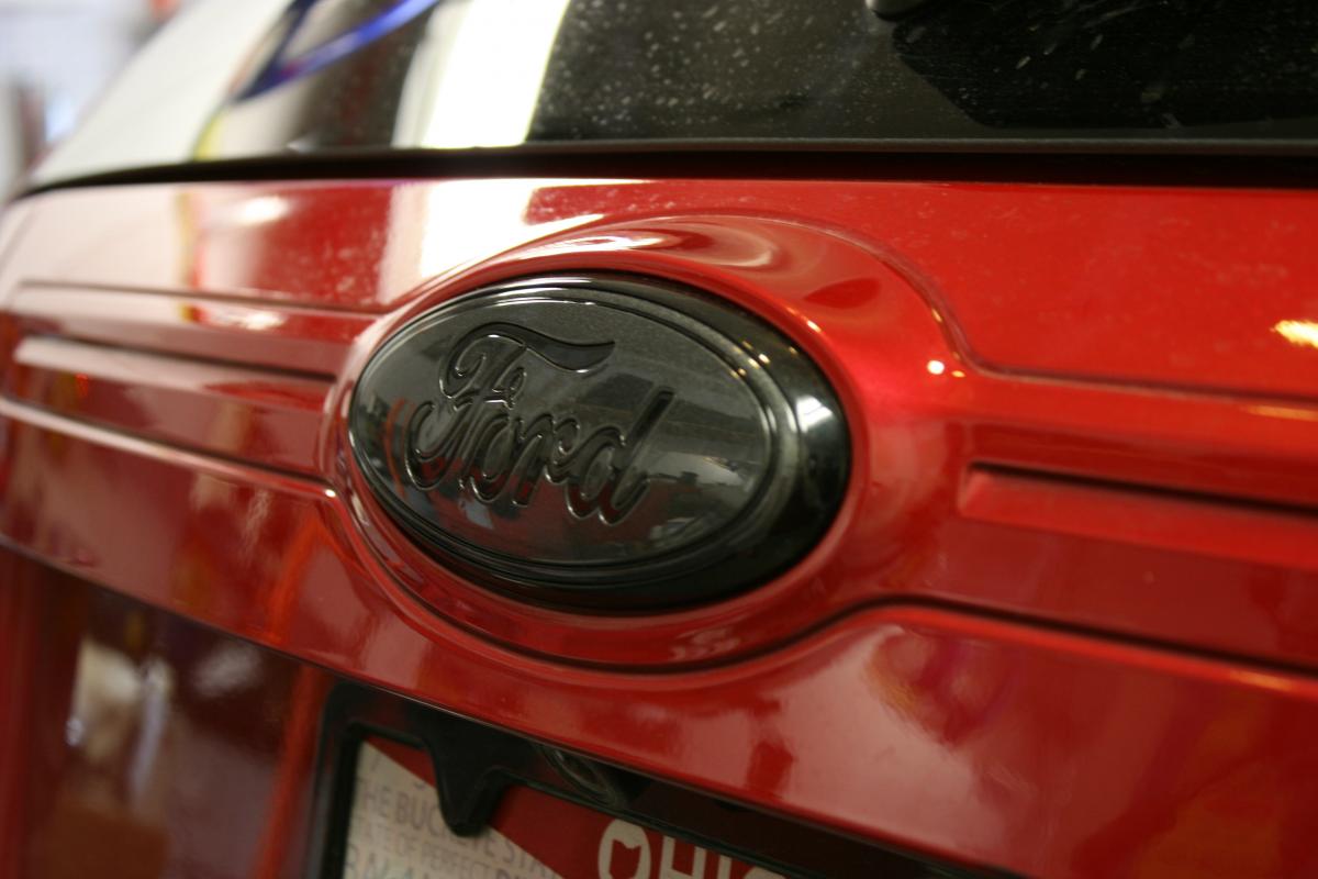

ExNascarDood Posted August 19, 2015 Report Share Posted August 19, 2015 (edited) How did u remove the rear one off the edge and where did u buy it at ? I used this one for the rear https://www.etsy.com/ca/listing/174341491/custom-ford-emblem-black-with-chrome?ref=shop_home_active_11 Very happy with it and fast shipping. Best part if it is a metal cover that goes over the existing emblem so you don't have to remove the current one at all. I just cleaned it with some rubbing alcohol and used the already attached adhesive tape on the cover to put it on. Just an option in case you don't want to bother removing the rear emblem ..... Edited August 19, 2015 by ExNascarDood Quote Link to comment Share on other sites More sharing options...

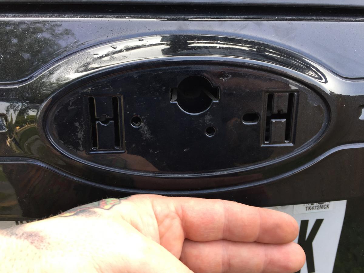

roots57 Posted July 17, 2018 Report Share Posted July 17, 2018 no removal of components is needed for the Gen-II rear emblem, just a heat gun/hairdryer (or even a hot day) and some fishing line, you basically just cut thru the adhesive with the fishing line, the warmer it is the easier it cuts. Quote Link to comment Share on other sites More sharing options...

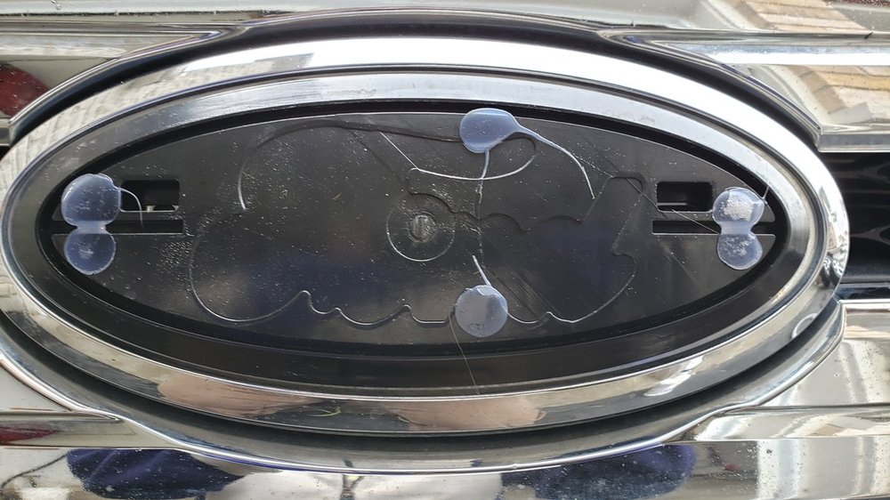

callatis Posted February 24, 2019 Report Share Posted February 24, 2019 On 5/13/2014 at 6:54 PM, strike2tamu said: Here is how I removed the front emblem on my wifes 2011 Ford Edge SEL. First remove the (2) 10mm screws and 4 clips located on the top of the shroud. Marked with red circles are the things that need to be removed. Then gently pull back the shroud in the direction of the yellow arrows, do not go to far, just enough to get you hand in the hole in the center. You are reaching in and unclipping the three points on the trim piece that actually holds the emblem in place. They are circled in red in the picture below. (You can probay just use a 10mm socket and take the two nuts of the emblem, I didnt try this because it was much easier to just push the tabs down and unclip it) After you have removed the emblem and trim (if thats the way you did it) you simply unbolt the emblem from the trim using a 10mm socket. The rest I am sure you can figure out, to replace just reverse the order of course. Pics below. Thanks a lot for your detailed procedure! I just did mine. I had to use a screwdriver to push the clips. I also had to hold the grill with one hand when I pushed the emblem back. Let's hope the replacement will be OK for the next 5 years. Quote Link to comment Share on other sites More sharing options...

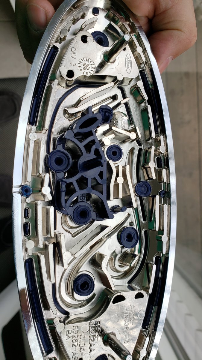

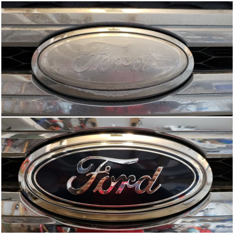

callatis Posted April 10, 2019 Report Share Posted April 10, 2019 Not even 2 months and I had to replace the after-market emblem one more time. The whole front plate was removed during my last car wash (Petro Canada). The front emblem was glued using hot glue, very cheap made. So I went to dealer and picked up an OEM emblem for $54CAD ($10 off). The good part is Ford decided to make new emblems, this time it's not blue enamel paint, the blue plate is made from plastic blue color. 1 Quote Link to comment Share on other sites More sharing options...
