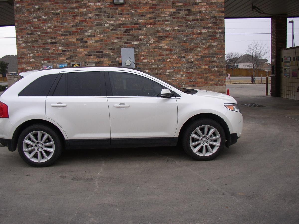

Jackman5000 Posted March 19, 2014 Report Share Posted March 19, 2014 Your help would be very much appreciated. Trying to sell my 2012 edge limited 18s to a lady w 2010 flex. I told her I would research as she is not very computer\car literate....guess I'm not either. Lol. I know bolt pattern will match....right? But are the hubs different size? Thank you!!!! Quote Link to comment Share on other sites More sharing options...
Waldo Posted March 19, 2014 Report Share Posted March 19, 2014 Hub size should be the same (the Edge changed to the Flex size hub in 2011). But the TPMS in the 2010 Flex is the older band style, so she will not be able to program the sensors in your wheels to her car. Quote Link to comment Share on other sites More sharing options...
ls973800 Posted March 19, 2014 Report Share Posted March 19, 2014 She should be able to install the band style TPMS onto the Edge wheels. Replacement bands are available since the factory ones are crimped and have to be cut off. All she would have to do is replace the bands and still use her old sensors. I went the other way and installed 20" Flex wheels on my 2013 Edge. Quote Link to comment Share on other sites More sharing options...
