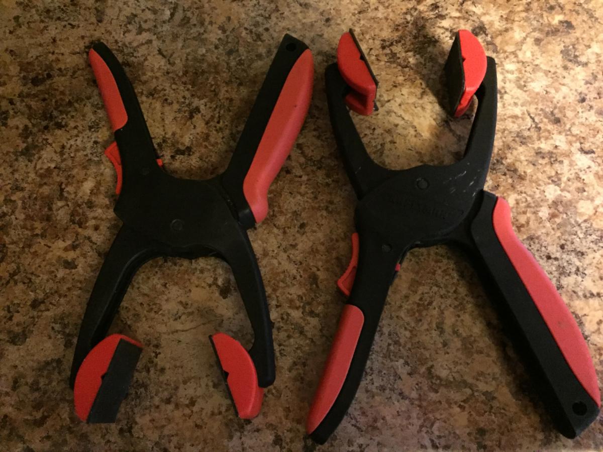

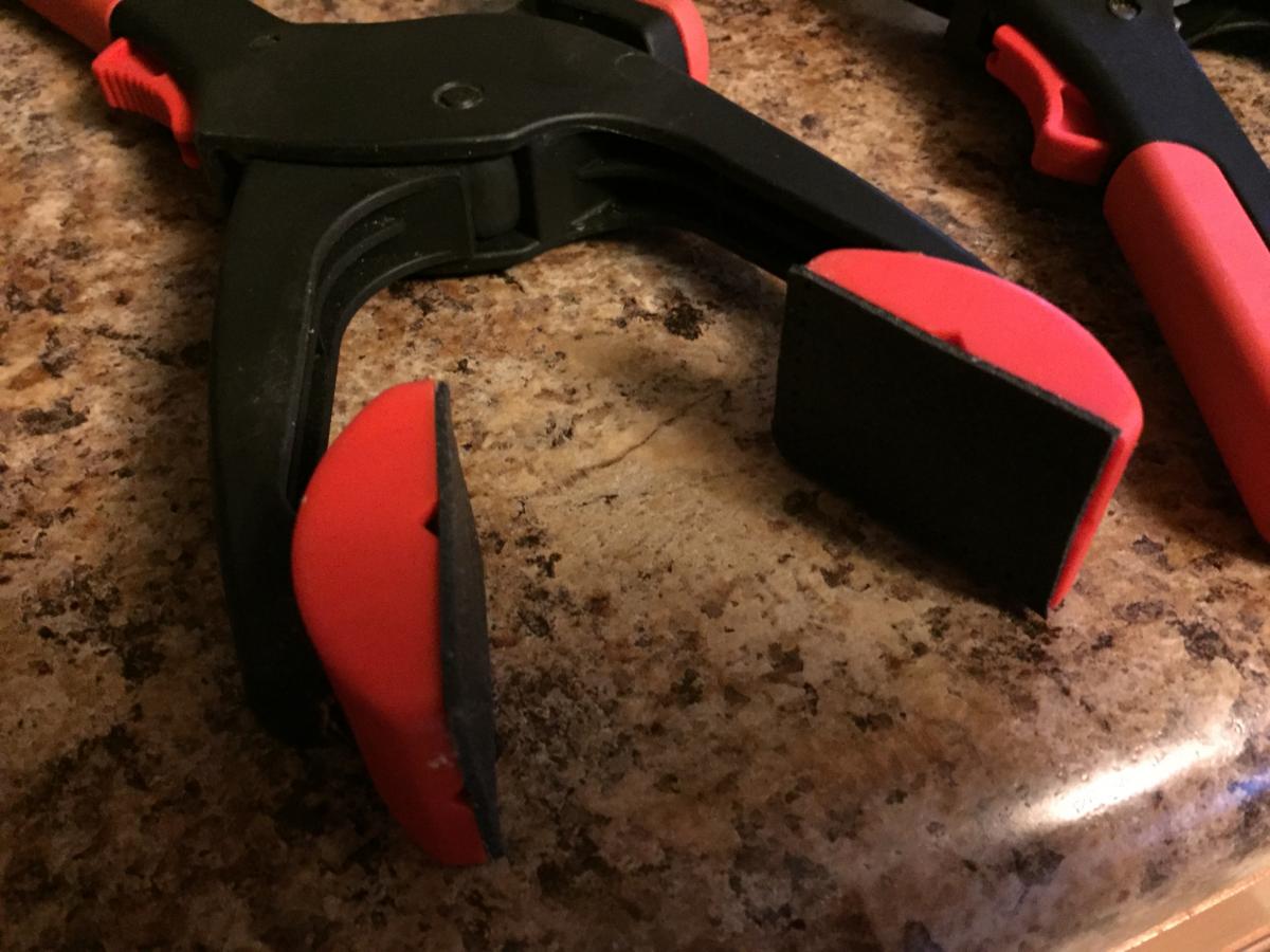

Hotrod1967 Posted January 1, 2016 Report Share Posted January 1, 2016 12Edge, many thanks for your write up on latch replacement !! I was able to replace the drivers latch in my wife's 12' Edge in about 2-1/2 hours. The only thing I did different, was use a pair of Craftsman clamps to hold the window up instead of using the tape. I added so foam pieces to the clamp jaws as they were originally hard plastic. Quote Link to comment Share on other sites More sharing options...
12Edge Posted January 20, 2016 Author Report Share Posted January 20, 2016 (edited) Good Call HotRod, I actually have a pair of those type of clamps. Guess I will get to try it now that my driver side REAR door is now door adjar'ing ! Ford has a DEFECTIVE part here and the price has gone up since I bought the front one by $50. What a racket :/ Ā Ā I guess putting my stuff in the back seat on the way to work and opening the door as much as the front door has taken its toll on that switch :/ Ā Full Retail do it yourself this is $1000 worth of parts for 4 doors. Come on Ford, Own your mistake. I have a note on a fixya account of 3,897 people helped with my link to this tutorial. If that doesn't indicate a defect/problem I don't know what does :/ Edited January 20, 2016 by 12Edge Quote Link to comment Share on other sites More sharing options...
