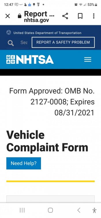

Linda27 Posted January 9, 2023 Report Share Posted January 9, 2023 Anyone having issues with their 2014 Ford Edge defrost system should reach out to the NHTSA and file a report. Maybe we can get a recall issued on the safety matter. Quote Link to comment Share on other sites More sharing options...
enigma-2 Posted January 10, 2023 Report Share Posted January 10, 2023 I could be mistaken, but I don't believe that this is a safety issue. In fact, I don't believe that even a heater is required by the Federal Standards. You can't start a recall over a defective convience item. Quote Link to comment Share on other sites More sharing options...
