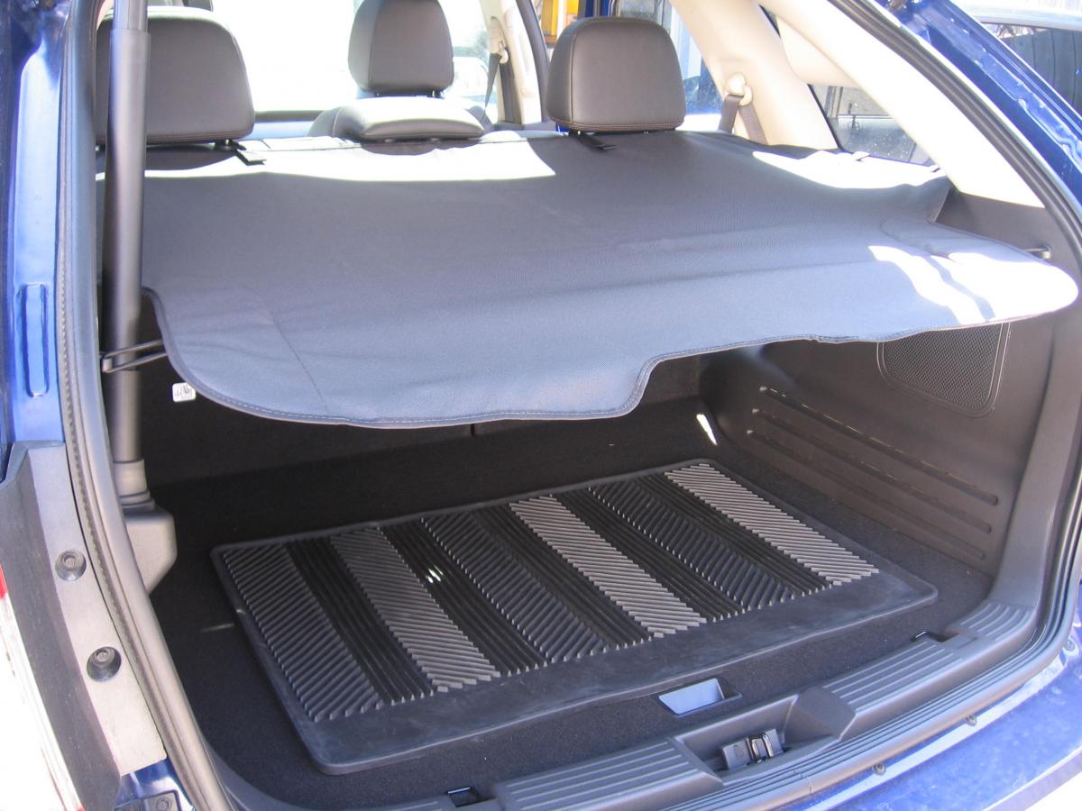

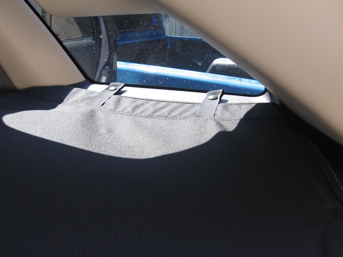

Uncoiler Posted April 26, 2014 Report Share Posted April 26, 2014 Here is a couple pics of my Ford Cargo Cover from the parts department. IMHO it should come with every Edge from the factory, but in any case it's part number DT4Z-7845440-AA. It was easy to install and I am very happy with it. Takes up virtually no room when storing folded up on top of my spare tire. Another thing I noticed is that it doesn't seem to affect the sound coming from the rear sub when the cover is installed. 1 Quote Link to comment Share on other sites More sharing options...
DavidE Posted June 19, 2014 Report Share Posted June 19, 2014 On 4/26/2014 at 11:06 PM, Uncoiler said: Here is a couple pics of my Ford Cargo Cover from the parts department. IMHO it should come with every Edge from the factory, but in any case it's part number DT4Z-7845440-AA. It was easy to install and I am very happy with it. Takes up virtually no room when storing folded up on top of my spare tire. Another thing I noticed is that it doesn't seem to affect the sound coming from the rear sub when the cover is installed.[/ That's the version I just got. Do the bolts feel like they'll stay in with frequent use? Quote Link to comment Share on other sites More sharing options...
Uncoiler Posted June 21, 2014 Report Share Posted June 21, 2014 (edited) I think the screws should hold well for a long time if it's installed correctly. The reason I think this is the cover material is fairly lightweight so it should not really put any stress on the snaps. Also you should not be putting anything on top of this cover, so again there should be no additional weight for it to support. Last is the snaps are not really tight fitting, meaning they pull apart or unsnap fairly easy. Tips I would suggest to be sure the screws hold tight are to use the correct drill bit that is mentioned in the instructions so the holes are no bigger than it needs to be. Don't go crazy with a highspeed drill so as to not heat up the plastic and make the hole bigger than it needs to be. In fact you could even use a pin vice or hand held drill bit tool if you like as the drill bit cuts through the plastic fairly easy. Last is don't overtighten the screws, just snug it up and stop. If you follow the instructions and tape down the template the holes will be in the correct positions (as I found out). Good luck. Edited June 21, 2014 by Uncoiler Quote Link to comment Share on other sites More sharing options...
