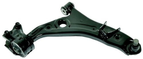

macbwt Posted March 10, 2015 Author Report Share Posted March 10, 2015 (edited) Not the news I was expecting. Tie rods are good. Seems the MOOG lower control arm ball joints on both the right and left side are worn with the right side being the worst and needing replacement soon. Only good news is the MOOG parts are under warranty and I am ordering the new ones then sending the old ones back. Bet ya can't guess what my next video topic will be? LOL So if you do not know how to replace a lower control arm on a 2007/8 and whatever Ford edge you will be seeing one side which is the same as the other being replaced along wiht sway bar links. Figure a week or so for them to get in then one saturday to work on it. Plus I am having some tire wear on the rears so I will most likely be replaceing the rear shocks since I am going to be putting on my summer tires. Ā Moog lower control arms made it about 60k miles before failure. Cost is $70.00 each. Full replacement warranty Ā Ford replacements are $231.00 each no warranty to speak of as I was informed. If so very short warranty but no lifetime. Ā I have already done this job once so a second time should be a little quicker. Not much rust on the bolts LOL Ā Only about four or five bolts all together I believe to remove. I do not have the PDF instructions, but would like them so I can include them in my video on this project> Akirby WWW? (you need a shorter name) LOL Edited March 10, 2015 by macbwt 1 Quote Link to comment Share on other sites More sharing options...

macbwt Posted March 11, 2015 Author Report Share Posted March 11, 2015 For those who monitor this subject in the Ford Edge forum. I will do my best to create a video of the removal and replacement of the Passengers side (right side) lower control arm/ball joint/sway bar link. Keep in mind removal of the sway bar link will be an tool removal then a saws all as I am not going to mess with it but just cut it off (saves time) besides that they are usually all rusty and difficult to work with anyway. I will video this one as it is the same thing for the other side. Hoping I will have an assistant to help me. Preteen camera girls can be finicky (on good days). 1 Quote Link to comment Share on other sites More sharing options...
macbwt Posted March 11, 2015 Author Report Share Posted March 11, 2015 (edited) This one is really really bad. Wheel wonders on turns and acceleration. This one went from slightly bad to terrible in just a day. It is bothersome as I know if this ball joint fails at speed the damage will be severe. Even at low speed it will not be good. At minimum I will lose the axel shaft/strut etc. Ā I think you will have better luck than having to use a bra as a fan belt I thought the noise was minimal at this point? Edited March 11, 2015 by macbwt Quote Link to comment Share on other sites More sharing options...

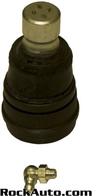

macbwt Posted March 11, 2015 Author Report Share Posted March 11, 2015 Hey look what I found on Rockauto.com I can just buy the ball joint for my Moog control arm and do not have to buy the whole control arm. The autoskills center has the pressing tools so this may have just become easier. I will check it out further later next week. 1 Quote Link to comment Share on other sites More sharing options...
WWWPerfA_ZN0W Posted March 12, 2015 Report Share Posted March 12, 2015 I personally would be wary of doing this type of work myself, taking it to a machine shop where they do this on a regular basis might be a better idea. Cost issue again, though, I guess. Do you have an "instructor" at the autoskills place that can make sure it's done right? Good luck Quote Link to comment Share on other sites More sharing options...
