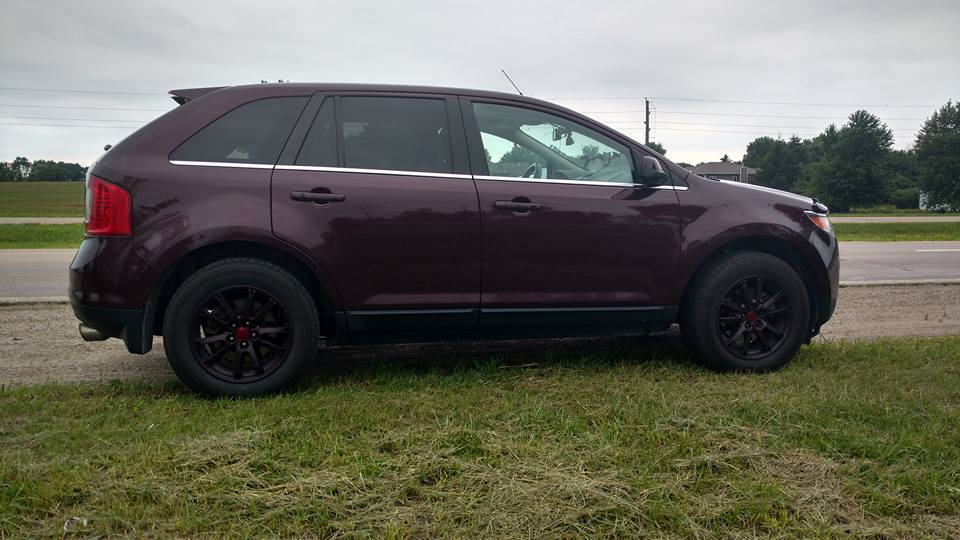

macbwt Posted June 30, 2017 Author Report Share Posted June 30, 2017 This is Lullubelle. LU for short. LU passed 200,000 miles yesterday and is running pretty good. Thanks to the Orange Crush LU has benefited from lessons learned and Ford Engineering improvements. LU stands in much better shape than the OC did at his point of 200,000 miles. I will be making a video on the history of maintenance/repairs on LU to this point of 200,000 miles. Here a few photos in the mean time. 2 Quote Link to comment Share on other sites More sharing options...
