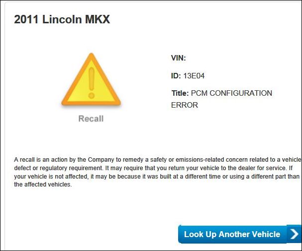

omar302 Posted February 18, 2014 Report Share Posted February 18, 2014 Today I found this under Outstanding Field Service Actions in Ford's Etis website: "13E04 - PCM CONFIGURATION ERROR", googling it I came up with the same number for a 2011 Explorer's Carfax report as a Manufacturer Emissions recall issued on 02/14/14. Can the ever so helpful members here get more details, thanks in advance, again. Quote Link to comment Share on other sites More sharing options...
Haz Posted February 18, 2014 Report Share Posted February 18, 2014 Try inputting your vehicle's VIN using this website, to see if it reveals any more detail... http://owner.ford.com/servlet/ContentServer?pagename=Owner/Page/RecallsPage The brief Action description from ETIS suggests the PCM might need reflashing. ETIS does not show this Action applying to my 2012 MKX. Good luck! Quote Link to comment Share on other sites More sharing options...
omar302 Posted February 19, 2014 Author Report Share Posted February 19, 2014 No extra info. This is what I get: Quote Link to comment Share on other sites More sharing options...
thirdgenlxi Posted February 19, 2014 Report Share Posted February 19, 2014 What's your VIN? I'll run it and see if it's affected or not Quote Link to comment Share on other sites More sharing options...
omar302 Posted February 19, 2014 Author Report Share Posted February 19, 2014 thirdgenlxi, on 19 Feb 2014 - 07:42 AM, said:What's your VIN? I'll run it and see if it's affected or not Thanks for the offer, I know that my vehicle is affected, the screenshot is for my VIN, I just erased it. Was wondering if there are any further details to the recall. Quote Link to comment Share on other sites More sharing options...
