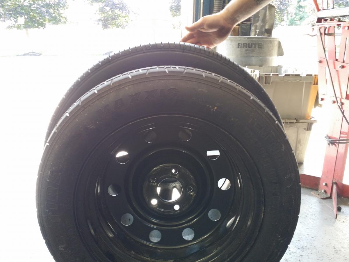

Dr Fildo Posted February 10, 2014 Report Share Posted February 10, 2014 I recently had a flat tire. First flat with this car. I have a 2008 AWD edge with 20" rims. I like that the spare is in the cargo area, but I was surprised to see that spare tire/donut is 17". I was under the impression that with AWD it was important to run all 4 wheels with the same tire size. The spare tire area is big enough to store the full size tire in there when the spare is on the car, so why wouldn't they supply a 20" spare on all vehicles with the 20"rim/tire? I bought the car used, so maybe the dealer switched the spare?? Has anyone else run into this issue?? Is the 17" spare standard on an AWD with 20" rims? Or is it no big deal to run a smaller spare tire? Quote Link to comment Share on other sites More sharing options...

Dr Fildo Posted December 1, 2014 Author Report Share Posted December 1, 2014 That's the donut in front. The 20' rim with tire is behind it. Clearly not the same diameter. I'm wondering how harmful to the differential it is to run on the donut. It can't be good. Quote Link to comment Share on other sites More sharing options...
akirby Posted December 1, 2014 Report Share Posted December 1, 2014 Not clear at all. You can't tell from that angle. What are the posted sizes of each tire? Quote Link to comment Share on other sites More sharing options...
Dr Fildo Posted December 1, 2014 Author Report Share Posted December 1, 2014 My wife has the car right now, but the camera is level to the top of the donut. There is approximately a 2-3 inch difference is size. I will post the actual tire and donut specs later. Quote Link to comment Share on other sites More sharing options...
WWWPerfA_ZN0W Posted December 1, 2014 Report Share Posted December 1, 2014 A 3% allowance is built into the AWD system, so if you are outside that, time to get the tire fixed/replaced pronto. Quote Link to comment Share on other sites More sharing options...
akirby Posted December 1, 2014 Report Share Posted December 1, 2014 If that's the case then I suspect someone put on larger aftermarket tires. The spare should match the factory tire diameter. That's why we need the exact sizes of both the 20" tires and the spare. Quote Link to comment Share on other sites More sharing options...
Waldo Posted December 1, 2014 Report Share Posted December 1, 2014 Ford's AWD systems are designed to recognize when you put a smaller spare tire on and they will disable the AWD system. As long as the tire is between I think 3% and 5% difference, the system will recognize it and no damage will be done. Quote Link to comment Share on other sites More sharing options...
akirby Posted December 1, 2014 Report Share Posted December 1, 2014 Interesting.......so the factory spare could be up to 5% smaller? Quote Link to comment Share on other sites More sharing options...
ls973800 Posted December 2, 2014 Report Share Posted December 2, 2014 You got me curious enough that I just checked the spare tire in my 2013 Limited. I purchased it new with the 20" wheel and tire option, and know that the spare has never been exchanged or even taken out of the vehicle. BIG DIFFERENCE between the two sizes used as shown! NOTE- I have a FWD model, not an AWD. Don't know if those spare sizes would be different. Factory tire size is 245 50 20 Spare tire size is 165 80 17 The first number is the factory 20 inch tire, the second number is the factory 17 inch spare tire as shown on a tire size calculator site. Tire diameter 29.6 inch 27.4 inch Sidewall height 4.8 inch 5.2 inch Rolling circum. 93.1 inch 86.1 inch Revs/Mile 680 736 Ride height difference -1.13 inch Rolling circumference difference -7.6 % Speedometer difference +8.2 % Speedometer reading at 60 mp/h 64.9 mp/h 2 Quote Link to comment Share on other sites More sharing options...

WWWPerfA_ZN0W Posted January 8, 2015 Report Share Posted January 8, 2015 (edited) Sounds like the PTU was already on the way out when the first incident happened, probably due to overheating due to low fluid level. No resort that I know of ... so far ... but to fix at your own expense. Could be a coincidence that it happened with the spare tire (meant for limited range driving, but sounds like you were WELL under), maybe not. Try calling Ford National Customer Service, or if that doesn't work out, Lincoln Customer Service. I hope our Ford rep on here (Tricia) will see your post soon and step in with advice. BTW, the difference is about 3" in height, I believe between the stock wheel and the spare: http://www.tacomaworld.com/forum/tirecalc.php?tires=245-50r20-165-80r17 which is still way above the difference the AWD can compensate for. Interesting tidbit I was unaware of (OM): "You should replace your spare tire when you replace the road tires or after six years due to aging even if it has not been used." "If your vehicle is equipped with AWD, a spare tire of a different sizeother than the tire provided should never be used. A dissimilar spare tiresize (other than the spare tire provided) or major dissimilar tire sizesbetween the front and rear axles could cause the AWD system to stopfunctioning and default to front wheel drive and could damage thesystem." "Each tire, including the spare (if provided), should be checkedmonthly when cold and inflated to the inflation pressure recommendedby the vehicle manufacturer on the vehicle placard or tire inflation pressure label. (If your vehicle has tires of a different size than the size indicated on the vehicle placard or tire inflation pressure label, you should determine the proper tire inflation pressure for those tires.)" Edited January 8, 2015 by WWWPerfA_ZN0W Quote Link to comment Share on other sites More sharing options...
