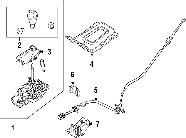

toast1850 Posted January 28, 2014 Report Share Posted January 28, 2014 Hi all, Looking to replace shift lever/knob on my Edge SE with the OEM Ford part# BT4Z-7213-FA- This one includes leather and chrome. I've searched the forums here but only found info for a 2008 Edge to disassemble. My question is, do I need to remove silver bezel trim to get to the shift knob? I noticed there is a screw in the illustration for the knob. I know that would need to be removed. Any help is greatly appreciated. Thanks Here is a diagram of the part#- Quote Link to comment Share on other sites More sharing options...
ls973800 Posted January 28, 2014 Report Share Posted January 28, 2014 From what I see in the service manual, you have to disassemble the complete console basically, and then remove the two screws or bolts that hold it on. The two bolts are near the lower portion of the "stick" which the knob attaches to. They are below the rubber boot and naturally below the plate which has the PRNDS. Looks to be a time consuming job and a lot of items to be disassembled. Quote Link to comment Share on other sites More sharing options...
toast1850 Posted January 29, 2014 Author Report Share Posted January 29, 2014 Ok, I thought it might be a quick swap out but looks like I'll plan a weekend for this so I don't have to rush. Thanks for the quick reply! Quote Link to comment Share on other sites More sharing options...
