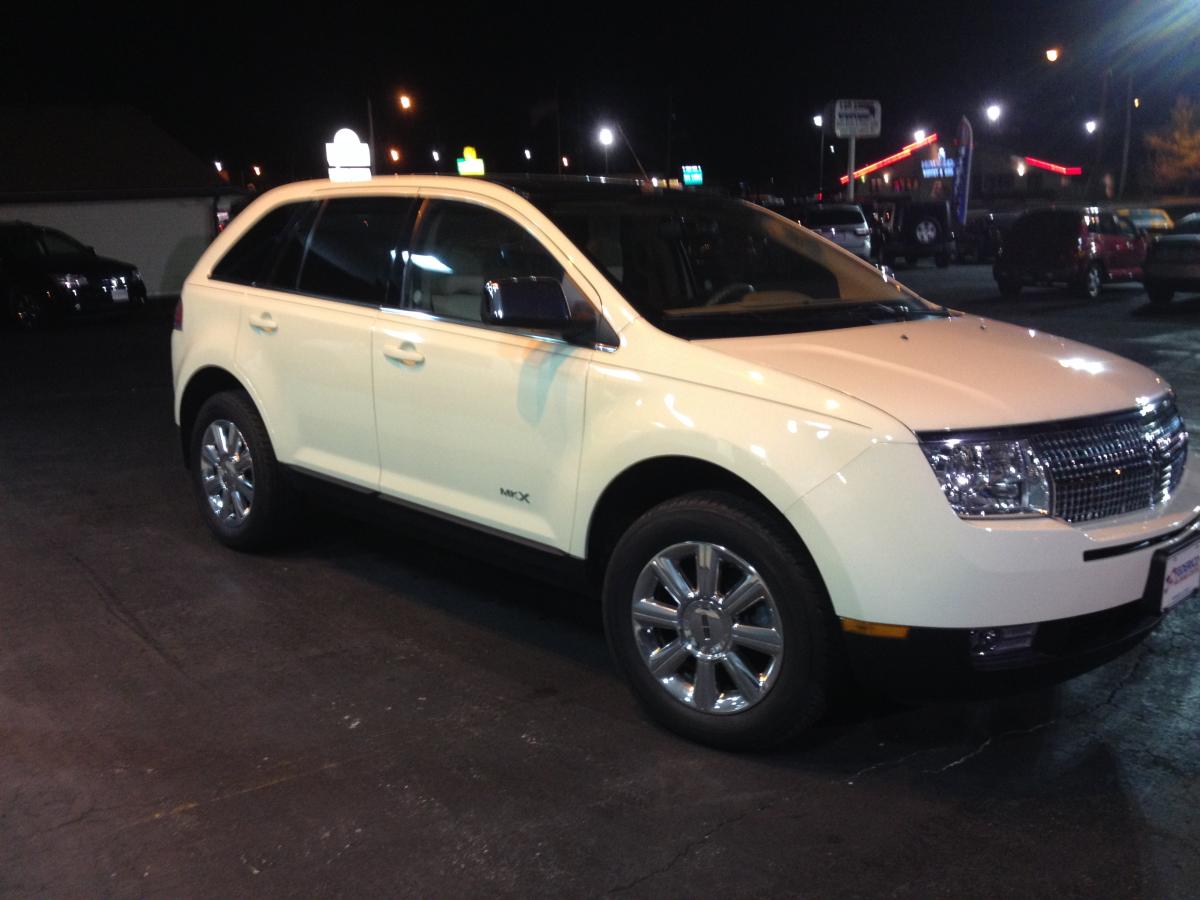

WWWPerfA_ZN0W Posted January 24, 2014 Report Share Posted January 24, 2014 Saw a Gen 1 Edge in that color today. Unfortunately all mucked up with snow/slush/salt. Still a nice color tho! Quote Link to comment Share on other sites More sharing options...
wojo Posted January 24, 2014 Author Report Share Posted January 24, 2014 It's that white chocolate color.......Most of the MKX's I saw for sale were Black.......I had my share of black vehicles. They look beautiful for the 15 clean seconds after you wash them but any dirt makes them look nasty. I could not find any nicks on this one...there are some scuff marks on the rear bumper from sliding things out of the cargo area. They will polish out when I get a chance. The interior was incredibly clean but well smoked in. The rear defroster worked when I got it but now the light don't go on.......seems like the heated mirrors may not be working..........It has 76K on it......My wife's last car (1999 Lincoln Continental) had 216K on it when I bought it........it now has over 300k and was passed on to my teenage daughter who was very excited to watch the odometer roll over to 300K.......... Quote Link to comment Share on other sites More sharing options...
