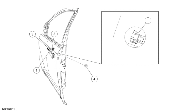

toast1850 Posted January 22, 2014 Report Share Posted January 22, 2014 Hi everyone, I've been thinking about removing the keyless entry keypad above the door handle on my Edge to paint it because it's textured black. I would assume I would need to remove the inner door panel first to gain access? Does anyone have any knowledge how to do this? Any info is greatly appreciated. Thanks Quote Link to comment Share on other sites More sharing options...
ls973800 Posted January 25, 2014 Report Share Posted January 25, 2014 (edited) Sorry I am just replying to your post and question now. Looks to be a very simple job, no interior door panel removal. Copied from my 2013 service manual for the Edge. Item Part Number Description 1 — Keyless entry keypad retaining clips (2 required) (part of 14A626) 2 — Keyless entry keypad electrical connector (part of 14631) 3 14A626 Keyless entry keypad 4 W651011 Upper access plug Removal and Installation Remove the upper access plug.Using a suitable tool (such as a long, flat-blade screwdriver), through the upper access hole, release the rear keyless entry keypad retaining clip and position the keyless entry keypad aside.Remove the keyless entry keypad. Disconnect the electrical connector. To install, reverse the removal procedure. Edited January 25, 2014 by ls973800 1 Quote Link to comment Share on other sites More sharing options...

DKS Posted April 25, 2015 Report Share Posted April 25, 2015 It takes a pretty long skinny screwdriver and I took a very small one to slide between the door and the part to put some pressure on it while I was pushing the tab in. It took less than two minutes to do the whole job. My numbers were wearing off and it looked bad. I found the part online in the correct color and it looks much better. Quote Link to comment Share on other sites More sharing options...
