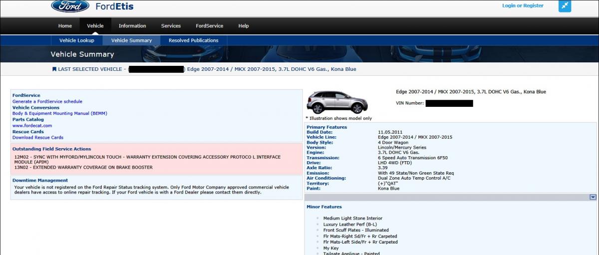

Kleber Gomes Posted August 29, 2016 Report Share Posted August 29, 2016 Hi, the TSB mentioning the extended warranty mentions that vehicles manufactured until March 28, 2013 will be covered. Doubts: 1. Any specific reason why only cars until this date? After this, what/anything happened that will prevent the failure to happen in newer models? 2. How can I find out the date in which my car was manufactured? (Mandatory to ask to a dealer, or is there any option)? Thanks, Kleber Quote Link to comment Share on other sites More sharing options...
WWWPerfA_ZN0W Posted August 29, 2016 Report Share Posted August 29, 2016 You can look up your vehicle's production date here: https://www.etis.ford.com As far as date range I am sure it is a combination of the vehicles that have been complained about and the batches of related parts involved. Quote Link to comment Share on other sites More sharing options...
Kleber Gomes Posted August 30, 2016 Report Share Posted August 30, 2016 You can look up your vehicle's production date here: https://www.etis.ford.com As far as date range I am sure it is a combination of the vehicles that have been complained about and the batches of related parts involved. Hi, I don't have access to this site. Is there any cost to get it? When filling in with my data, it was asking an address for invoicing :-0 Quote Link to comment Share on other sites More sharing options...
WWWPerfA_ZN0W Posted August 30, 2016 Report Share Posted August 30, 2016 That is strange, maybe they have country restrictions? Did the website come up at all? Did it display a Vehicle Info tab and did you click on that and fill in your Edge's VIN? If you post some pics of what's happening when you visit the site, it will be helpful. Quote Link to comment Share on other sites More sharing options...

Kleber Gomes Posted August 31, 2016 Report Share Posted August 31, 2016 That is strange, maybe they have country restrictions? Did the website come up at all? Did it display a Vehicle Info tab and did you click on that and fill in your Edge's VIN? If you post some pics of what's happening when you visit the site, it will be helpful. Sorry, it was my mistake. Understood I had to create an account to get access to the information, but actually this is just not needed. Well, after checking in Etis, just found out that my car: Build Date: 19.04.2013 The TSB states that extended warranty would be provided to vehicles manufactured until March 28, 2013, therefore mine is out of the extended warranty. Is there any track of records of brake problems happening with Edge 13 manufactured after March/13? Has Ford changed anything in the production after this date? Thanks/Kleber Quote Link to comment Share on other sites More sharing options...
WWWPerfA_ZN0W Posted August 31, 2016 Report Share Posted August 31, 2016 Your vehicle is JUST past the limit, so it may be something your dealer can take up with Ford, or you can contact Ford directly. Quote Link to comment Share on other sites More sharing options...
