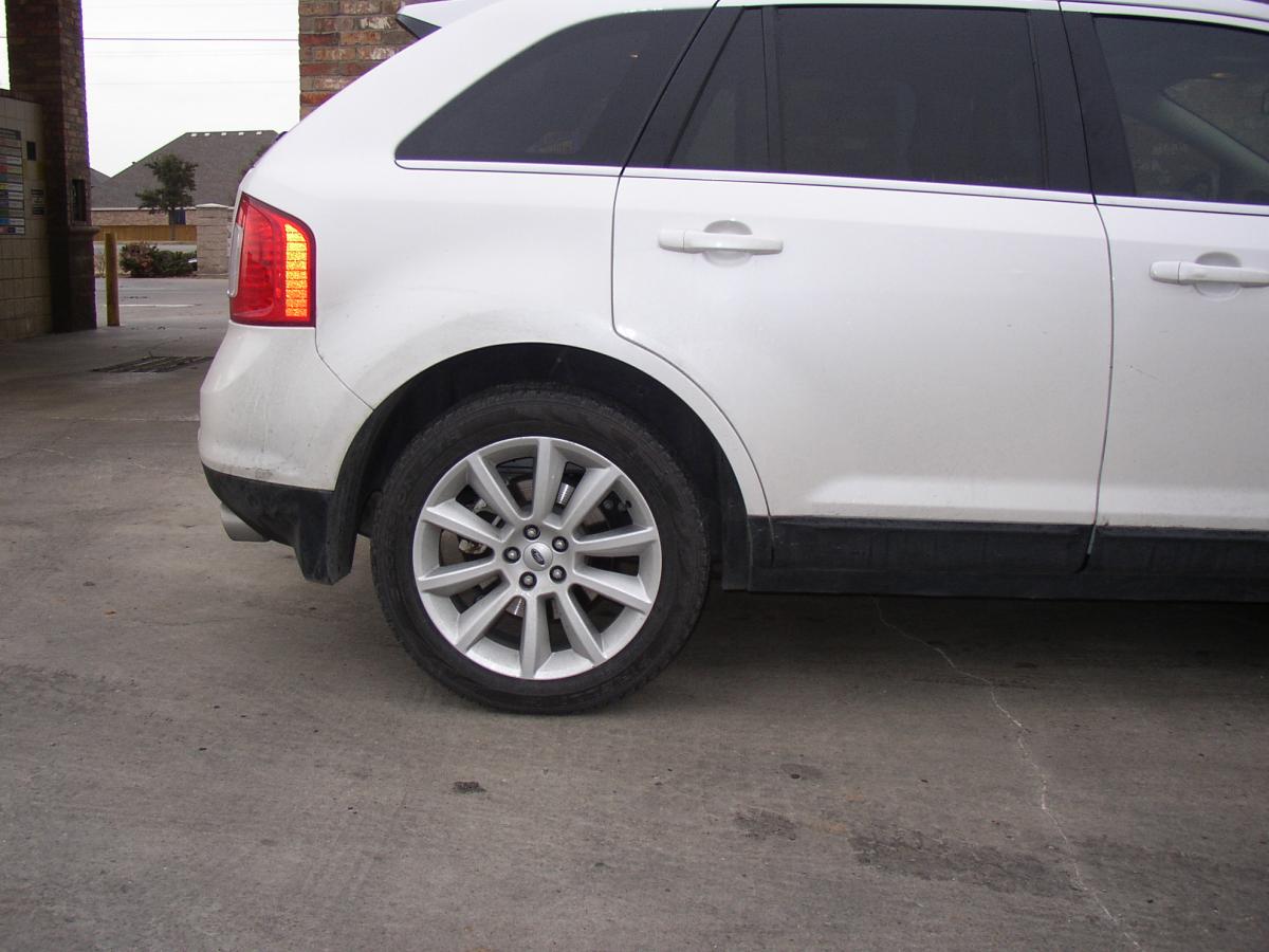

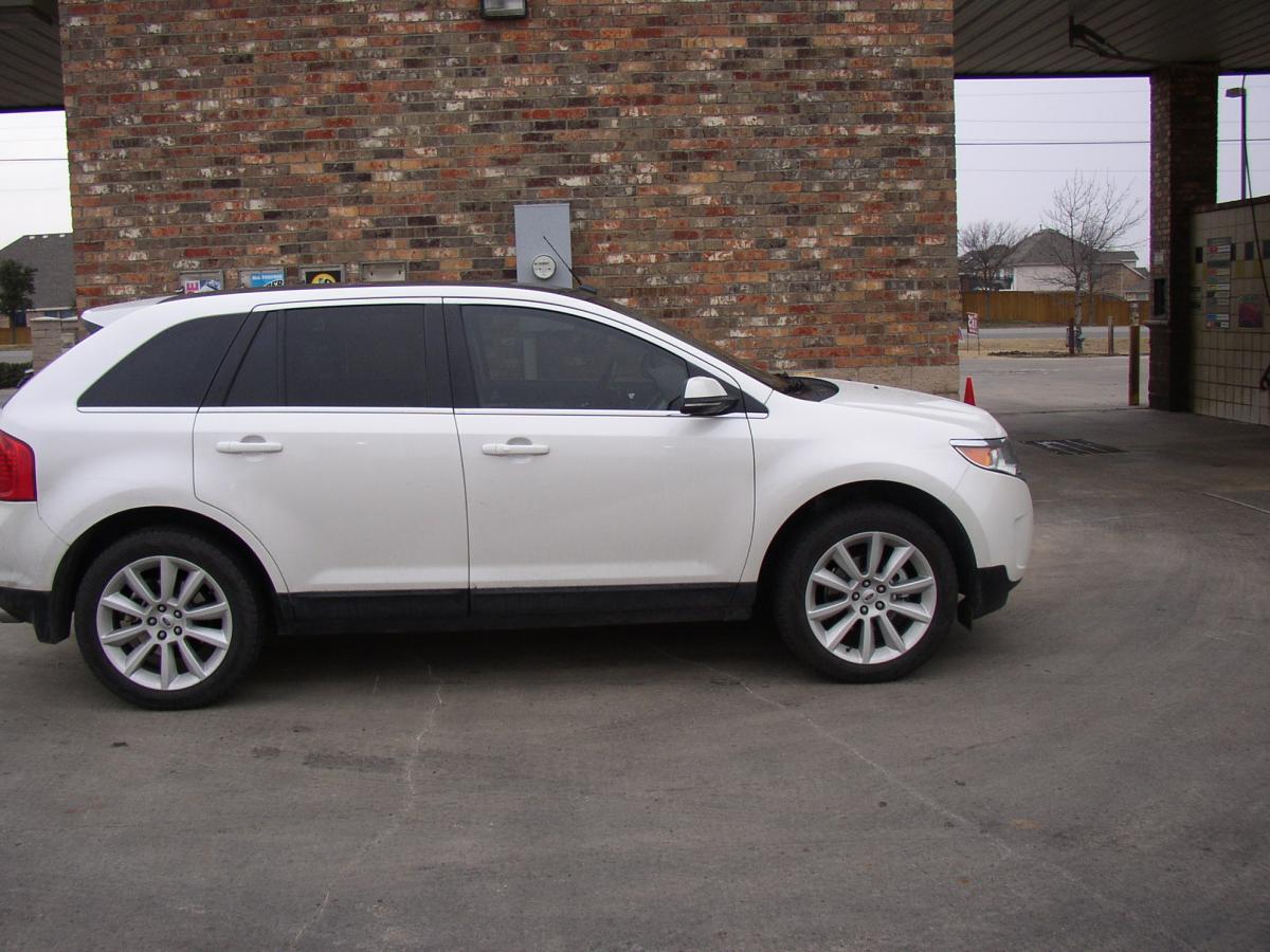

ls973800 Posted February 11, 2014 Report Share Posted February 11, 2014 Is973800, Any chance we can see some pictures of those wheels on the Edge? Sorry the car and wheels are dirty, but the weather has been crazy around here. I took it up to the car wash to clean it before taking pictures but because the temperature is around 32, he closed the wash due to freezing concerns. 1 Quote Link to comment Share on other sites More sharing options...
DMatherne Posted February 11, 2014 Report Share Posted February 11, 2014 Sorry the car and wheels are dirty, but the weather has been crazy around here. I took it up to the car wash to clean it before taking pictures but because the temperature is around 32, he closed the wash due to freezing concerns. P1010009.JPG P1010007.JPG P1010008.JPG Looks amazing. I am trying to convince my wife we need these 20" wheels for our 2013 Limited. I am not impressed by the 20" chrome clad wheels it came with. Just from everyone else's experience... I could use my existing tires, TPMS sensors, center caps and lugs, correct? I'd need a balance with the new wheels at the least, but I can probably skip on an alignment? Quote Link to comment Share on other sites More sharing options...
ls973800 Posted February 11, 2014 Report Share Posted February 11, 2014 Yes, you can use the same lugs, center caps, and TPMS. I changed mine out when the car was still only about 2 months old. I read too many horror stories of people looking for replacement chrome clad wheels because they hit a curb. The wheels were not repairable, so you either had to drive with bad looking wheels, or replace them. I sold all four of mine to an owner who's wife also had an Edge. Between the two of them, they had 2 ruined wheels, and knew it would happen again. He was happy to purchase my wheels for $1000.00 and have two spares for the next time! Very happy with these alloy wheels now. I found them on eBay for $625.00 which included free shipping. Quote Link to comment Share on other sites More sharing options...
