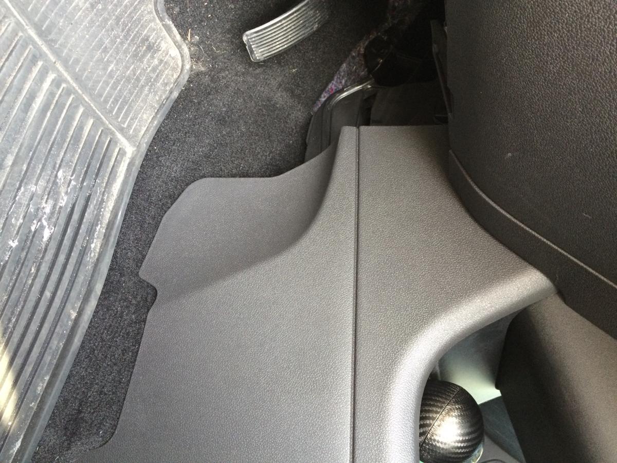

ravishingrocket Posted May 6, 2014 Report Share Posted May 6, 2014 (edited) Tapping on this panel duplicated my rattling noise. I just put some foam padding behind there and no more noise. Edited May 6, 2014 by ravishingrocket Quote Link to comment Share on other sites More sharing options...
Stoln Posted June 30, 2014 Report Share Posted June 30, 2014 (edited) I had the same issue and when i tapped on the big black platic panel under the steering wheel i could make it happen, I took it to the dealer and we drove on a bumpy road and of course the sound would no duplicate however the mechanic said he heard noises, they fixed it I beleive by insulating the steering column as he said things attached to it could rattle and make noises. Hope this helps all who have this and hopefully this rattle you have is same as mine and yes 2013 SEL AWD. Edited June 30, 2014 by Stoln Quote Link to comment Share on other sites More sharing options...
