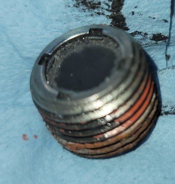

Cerberus Posted April 19, 2023 Report Share Posted April 19, 2023 So, i've been chasing a sound like a rear wheel bearing or oddball tire tread wear pattern was making a sound of a howling from the rear, right side i think. I have the hub and hardware but i wanted to look hard at it before i dove ito that task and make sure it really needs it. Zero play in the wheel, no oddity to the tread.. WTF? So I jacked it up further and rolled under to look around. Discovered that the RDU right side output seal has been leaking and the pumpkin is chunky with adhered dirt stuck to the once active leak. Pulled the fill plug, which was furry with fine metal filings, and added fluid.. and it took a lot more than I expected it might. Like about 1/2 quart.. and it only holds 830ml.. +/- 30 I'm hoping its not damaged too badly, but i guess i need to start looking for an RDU 2 Quote Link to comment Share on other sites More sharing options...
TourGuide Posted April 20, 2023 Report Share Posted April 20, 2023 Wow - that is a lot of shavings on that magnet. What model year do you drive? 1 Quote Link to comment Share on other sites More sharing options...
Cerberus Posted April 20, 2023 Report Share Posted April 20, 2023 7 hours ago, TourGuide said: Wow - that is a lot of shavings on that magnet. What model year do you drive? It's a 2016 sport with a hair over 92k on it And really that's not too much on the magnet. I mean none would be ideal, but I've seen much worse. The fluid top up has not changed the noise much, if at all, so it's likely that I will end up needing to do the wheel hub.. but I've expected that for over a year. Ironically the dealership said they could not replicate the problem when they had it for the brake line recall 18 months ago, which just pissed me off. Just joking here, but the thought occurred to me to take the bad part, once its been replaced, and heave it through their front window and ask if they can find the problem now ? 2 Quote Link to comment Share on other sites More sharing options...
WWWPerfA_ZN0W Posted April 21, 2023 Author Report Share Posted April 21, 2023 (edited) if the fluid has never been serviced, that is not bad. breakin metals accumulate on the magnet. if you dont find slivers or chunks, you *should* be good. now as to the clutch portion of it ... mercon lv filled ... idk. you may indeed have to get a new rdu if that is bad or source the viscous coupler and replace just that piece. @Special_K had sourced a high end version of the coupler for his sport project. idk if that is still an option. Edited April 21, 2023 by WWWPerfA_ZN0W 2 Quote Link to comment Share on other sites More sharing options...
Cerberus Posted April 21, 2023 Report Share Posted April 21, 2023 4 hours ago, WWWPerfA_ZN0W said: if the fluid has never been serviced, that is not bad. breakin metals accumulate on the magnet. if you dont find slivers or chunks, you *should* be good. now as to the clutch portion of it ... mercon lv filled ... idk. you may indeed have to get a new rdu if that is bad or source the viscous coupler and replace just that piece. @Special_K had sourced a high end version of the coupler for his sport project. idk if that is still an option. There were some small shiny bits but pretty minimal. I figure I'll run it a bit and suck out the old and refill. I've already started searching for RDUs and there are a bunch available out there, but minimal info on them. Any resources you can point me to on that would be appreciated 2 Quote Link to comment Share on other sites More sharing options...

WWWPerfA_ZN0W Posted April 25, 2023 Author Report Share Posted April 25, 2023 On 4/21/2023 at 11:40 AM, Cerberus said: There were some small shiny bits but pretty minimal. I figure I'll run it a bit and suck out the old and refill. I've already started searching for RDUs and there are a bunch available out there, but minimal info on them. Any resources you can point me to on that would be appreciated https://www.fordpartsgiant.com/parts/ford-axle-asy-rear_s-158-a.html?vin=&make=Ford&model=Edge&year=2016&submodel=&extra1=&extra2=&filter=(21805;1886) this is the rdu pretty pricey at just over 1,000 USD. sometimes for some mys you can get the viscous coupler separately if that is all you need, but i assume you feel the gearing portion is faulty not the clutch. 1 Quote Link to comment Share on other sites More sharing options...
Cerberus Posted April 25, 2023 Report Share Posted April 25, 2023 3 hours ago, WWWPerfA_ZN0W said: https://www.fordpartsgiant.com/parts/ford-axle-asy-rear_s-158-a.html?vin=&make=Ford&model=Edge&year=2016&submodel=&extra1=&extra2=&filter=(21805;1886) this is the rdu pretty pricey at just over 1,000 USD. sometimes for some mys you can get the viscous coupler separately if that is all you need, but i assume you feel the gearing portion is faulty not the clutch. The noise I'm chasing is almost certain a wheel bearing, but the nearly empty rear diff has me questioning that now, so I'm do preemptive research. I found a bunch of RDUs on ebay, new and used, but there are more versions of it than what the edge has and I'm wondering about cross compatibility and power handling capabilities.. like one for an explorer sport with the 3.5 ecoboost would have to be able to handle a lot more power.. So if it were bolt up possible and geared the same, it would be an idea to contemplate. New tires arrive today so I can emilinate that as a possible cause once they are installed. 2 Quote Link to comment Share on other sites More sharing options...
