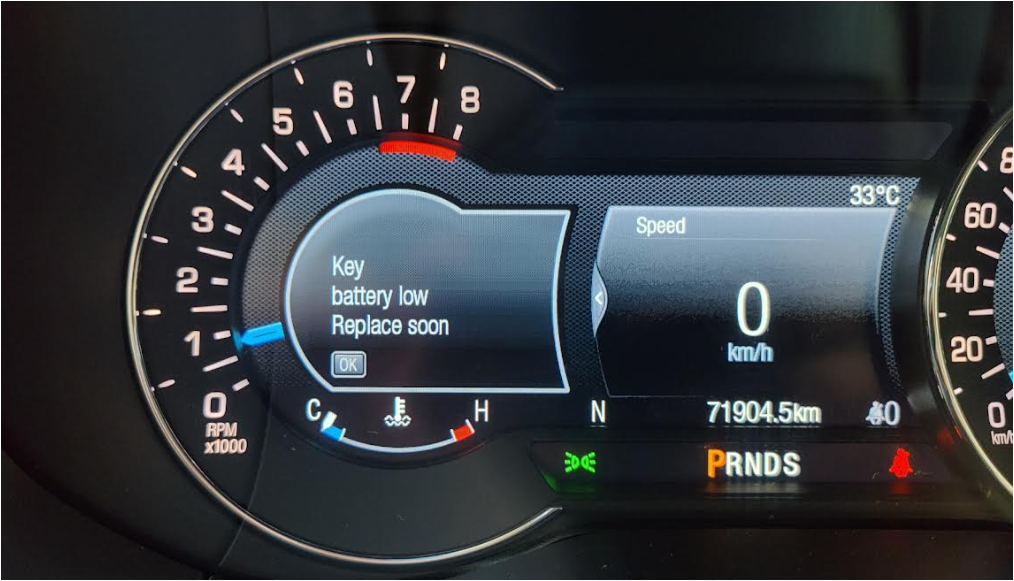

PrinzII Posted January 30, 2023 Report Share Posted January 30, 2023 On 9/5/2022 at 8:43 PM, omar302 said: Replaced the Key Fobs battery. Got a "Key Battery Low" message. Battery lasted just over 3 years. This is for the 2019 style keyfob I added to my 2016 Edge (link). Getting that message with my 2018 these days. Going to change the battery tomorrow. 1 Quote Link to comment Share on other sites More sharing options...
